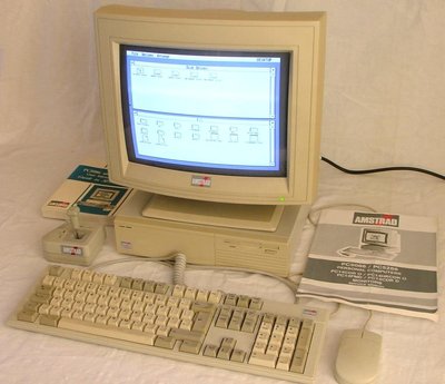

Is your machine the one listed under Series 4 near the bottom of this page?
I know the later MegaPC (also a 386) had a different set of system disks to my 286 and additional game bundles as well (see attached image). It's possible your System Disks are the same as the 386 Mega-PC ones.
I've searched the web high and low for disk images to compare with my own, but this stuff seems pretty hard to find and niche!
Re: the Mega-PC bundle image below: the yellow and red manual and two red and white floppies is the game bundle I have. Mine also came with the Counterpoint floppy and a different (as mentioned above) single "Series 5" system disk. Looks like the 386SX machines had 8two* system disks, which I'm awfully curious about! I can't read the other disk labels, but if the MegaPC came with Windows, that means the 7 floppies on the right might me that, and the three with Counterpoint could be the other games (Steel Empire, Snooker, Elite Plus) bundle or vice versa. The purple label disks look to be MS-DOS (I think it shipped with MS-DOS 5.0).

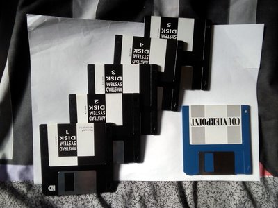

Reply 3 of 18, by gca
Judging from the images you have there the software bundle looks much the same as mine.
I had 5 (I think it was 5) setup disks for the basic OS install of DOS 3.3, Windows 3.0 (always considered odd as Windows 3.1 was available by then), CA-Compete Demo, CounterPoint. The games manual looks the same (yellow cover, red spine, multilingual), the operating system manuals were chunky as was the hardware manual (I miss having decent hardware docs).
I think you are right about which machine I have, it was reviewed in PCW Volume 14 Number 5 (May 1991) if you want to look it up.

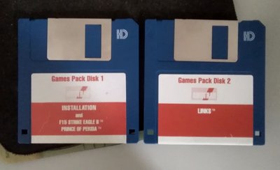

Reply 4 of 18, by Banjo
Yes!!! Those are the same floppies and the same red/yellow (thick!) manual! I'd love images of them to compare with mine! I thought I was the only one with surviving disks and even then wondered if mine were damaged!

    The file "prince.com", included with the Amstrad Games Bundle version of PoP that you're expected to run instead of the usual "prince.exe" file. DOSBox won't run this, but the game works if you add "prince.exe" from another copy. Does "prince.com" need to detect real Amstrad hardware, perhaps?
Reply 7 of 18, by gca

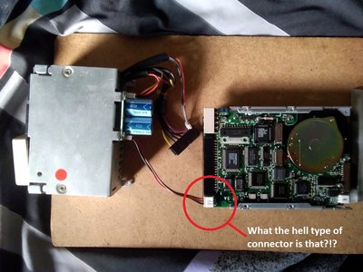

Found the system disks and counterpoint, I had them imaged on my external hdd.
I think the main problem with these machines is that they have so much proprietary or oddball hardware in them. The PSU in mine is definitely non-standard and probably impossible to replace. And what is it with that stupid 3 pin hdd power connector (see pic). Only managed to get a replacement drive because I lucked out working at a salvage place I was working at. And no standard molex on the psu either to add insult to injury.
My floppy drives belt (yes, it's belt driven) failed and took one of the drive heads with it. Can't find a replacement drive for love nor money so I had to resort to some extreme measures as you will see in the attached PDF.

Loud crack probably means a blown cap. My PSU is thankfully still operational even though the switch is jammed in the on position (better than being jammed off I guess). My replacement HDD sounds like a mini stone mason is chiselling the data onto a granite platter so I don't hold out hope for the machine being operational for much longer. But it has served me well, got it back in the mid 90's and it still lives so I can't complain too much.
And the keyboard LOOKS like a normal 5-pin DIN but isn't, which is a bugger because there is no real hope of connecting the machine to my KVM switch. Unless I find a busted keyboard and manage to work out what pin does what an cobble together an adapter.

I really need to dig out my old PC5286. I should still have the keyboard too, and I distinctly remember it having an odd DIN-style plug and realising I couldn't use a different one! Can't remember if the mouse was too.

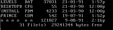

Noticed an rather strange filename in the Pop directory, looks like a line of pyramids separated by spaces (see screen grab). Corrupt file or is that supposed to be there?

Reply 13 of 18, by Banjo
Yup, that's exactly what I found in PCem and DOSBox, too, so it seems PoP and F15SE2 are indeed wanting real Amstrads to run, I think.
I've just finished my little patch and will post it tomorrow if you'd like to test it, but in the meantime, here's something interesting about that weird "glitchy" file you noticed... try renaming it to "PRINCE.EXE" and run it on your virtual machine... it's the game's freaking executable! 😀
Another interesting thing, this time about F-15 Strike Eagle II... I installed the original retail from a floppy image and it *does not run* either. Just hangs at the prompt in a similar way to the Amstrad version. But when (as I did to fix the Amstrad version) I replace my retail floppy's F15.COM or the Amstrad's F15LOAD.COM with one I found online, the game runs. Peeking at the "found" .com file (which is much smaller than the retail one but the same size as the Amstrad one) in a hex editor shows it to be very similar to the Amstrad one.
My theory is that the retail game might require the original disk in the drive to play it; I haven't tested that yet. The "found" file is from a later release (later datestamp, too) that didn't require this. The Amstrad version *also* doesn't require the original disk as it's meant to be played off the HDD... but it *does* require said HDD to be in a real Amstrad! It's just a theory though, but links up with another post I saw on here about F15SE2 not working in DOSBox for someone who bought the disks off eBay while everyone else was baffled saying "it's not a hard game to run"... since they're likely only familiar with the later/widely-available-online version! If it's true, though... wow, we think DRM is crazy today! 😀
In any case, I've made a patch to fix both games so they run on non-Amstrad (real or virtual) machines, and will give it to you to test tomorrow, since it's getting late here, and I want to add a quick readme file to it before posting.

Ah, disk based copy protection, oh I have missed thee (NOT). A necessary evil when games were just a diskcopy away. F16 combat pilot is the same way, it also needs the original disk in the drive to run. As if entering word x from line y on page z of the manual wasn't enough. Could be worse, the games could by on those disk with an odd format that simply refuse to be copied no matter how hard you try.
Didn't think to try renaming that odd file. I wonder why they didn't just remove it outright and save a little disk space. I'll try renaming it tomorrow and see what happens.
