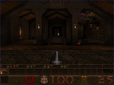

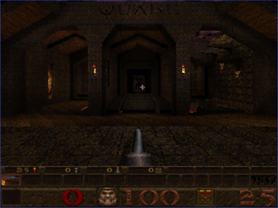

Let's have a look at a side-by-side comparison of DOS Quake at 200p and then at 240p respectively.
68.9 KiB
4638 views
89.99 KiB
4638 views

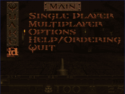

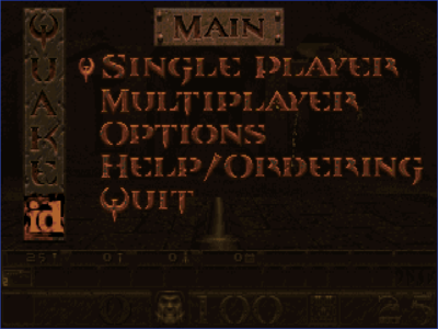

Don't see it yet? How about now?
45.83 KiB
4638 views
49.2 KiB
4638 views
That's it.
Every 2D Texture, from the menus, to the console, to the hud, to even the crosshair are stretched when displayed at 240p because it then renders all these textures with square pixels instead of non-square pixels. To put things into context, most DOS game developers, including Id Software, designed their 2D texures with non-square pixels in mind.
Most people are used to the stretched look from 240p, 480p, etc. because no source port that I could find has ever made the effort to replicate these non-square pixels in the menus. This essentially means that most people cannot viably experience true vanilla Quake without having to jump through a bunch of hoops to get it working in some sort of VM or suffering with DOSBox's terrible performance handling.
