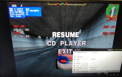

Reply 28 of 29, by Spark
Hey kickloch, thanks for the tips, you are right it DOES work. I did some more testing using OSSC, which displays the actual refresh rate, and after running mgamon and setting 1024 768 @60, (which creates the inf file) it does adjust the vertical refresh down from 85hz to around 75hz.
- it doesn't work through my monitor's vga port. Only using OSSC on the DVI port, and only with 'Allow TVP HPLL2x' enabled could it get a picture. Also, picture quality is improved with 'Allow upsample2x' enabled.
- the game starts on a corrupted screen if my pci sound card drivers are loaded (SB Live sound card), so no sound in msi mode for me
- fewer lines are displayed, presumably because of the lower refresh rate, some of the top and right of the picture were lost, not a disaster though, still playable (see screenshot), looks like it's missing 25 lines according to the OSSC
