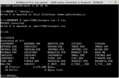

You need to mount two drives in Dosbox.
The first mount: use the MOUNT command, to mount a specific folder (a new empty folder created by you in advance, the first time - somewhere on your physical hard drive - to be kept and re-used in future), as C. This will act as DOSBox's persistent storage, it's own internal version of a C: drive. To install programs onto, for example.
The second mount: use the IMGMOUNT command, to mount your ISO file, as D. Use the "-t iso" (meaning "type = ISO") suffix with the command.
Then, navigate to your newly-mounted D drive in DOSBox, with command "D:", followed by the command "DIR/W" (=show me the directory contents of this location, displayed as Wide view), you should see the contents of the ISO.
Then run your program's installation command. I believe (iirc) yours is "dossetup". In my example image below, it was "install".
16.83 KiB
965 views
Point the installation procedure to install to a location on your "C" drive.
Then in future when you run DOSBox, mount your C as the same location, and your installed program should persistently remain. (and will have it's own set of commands to invoke, which we can help you with, should you reach that stage)
I hope these instructions are specific enough. It is difficult to know what another person's sticking points will be.
