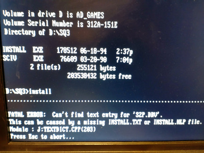

Have just tested using Space Quest 3 on the PC3086 (NEC V30) - it looks like there is an error ?
The attachment DSC_3287.JPG is no longer available
HI,
Can you open the resource.cfg file in a text editor and manually change the driver in there ?
Just change it from ADL.DRV (if you're set to adlib sound, or any other audio driver currently used in the file to S2P.DRV)
Also, make sure the new GM driver is in the directory and is called S2P.DRV
I've seen this issue happen with me too.
I could'nt launch the install program to change the driver, so i had to do it manually in the resource.cfg file.
I'll bring this to the attention of the driver's developer...
Thanks!,
Terrence
Hi Terrence,
I can confirm it works after manually editing the resource.cfg ! - I've tried it on Space Quest 3, Laura Bow 1: The Colonel's Bequest and Codename Iceman - all three of these work with the driver, but need the manual edit of the .cfg file first. The games play fine and I haven't spotted any problems during the quick play test's I did.

Reply 14 of 19, by Zalog
radiance32 wrote on 2021-11-10, 08:48:
That's great :) It works on all old PC systems now :) We'll look into the remaining issue with the driver name and the install p […]
That's great 😀 It works on all old PC systems now 😀
We'll look into the remaining issue with the driver name and the install program,
and hopefully peter from serdaco can get that fixed and check in a final, %100 version of this driver...
Thanks again for helping to test the driver on a 8086 and NEC CPU,
it's highly appreciated 😀
I was actually suprised it works on the VGA remake too 😀
Sounds pretty good aswell 😀
Thanks!,
Radiance

Reply 15 of 19, by radiance32
Zalog wrote on 2021-11-10, 09:51:
No problem - yes the VGA remake is one of the later SCI0 games - so its a good test as it really stresses the 8086. It might be […]
Thanks!,
Radiance
It might be worth testing the last SCI0 game some time - Jones in the Fast Lane - as it uses the SCI1 256 graphics engine inside SCI0 so would stress things, but unfortunately I don't have a copy.
Still well done and thanks again for all the work on the driver !
I'm sure you should be able to find a copy, or a copy by just googling for it...
Then again, I'm focussed on HP200LX portables which have CGA so I can't test any of the sierra VGA only games...
Radiance
Check out my new HP 100/200LX Palmtop YouTube Channel! https://www.youtube.com/channel/UCCVChzZ62a-c4MdJWyRwdCQ

Reply 18 of 19, by LordMortiferus
Thanks a lot for the driver!
I did a quick test with the S2P on a IBM 5160 with NEC V20 and IBM 5155 with 8088 CPU. Space Quest 3 and Codename:ICEMAN worked just fine. Though I wouldn't call it playable.
The 1988 X-Mas card had audio only on the first screen, however I am not sure if Ravi's original gm.drv is compatible with it to begin with.
