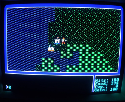

I have a Compaq 425 all in one system that has 20MB and 486dx100 overdrive chip. Every Ultima game I've tried so far has worked well, except for some sound glitches with the later games.

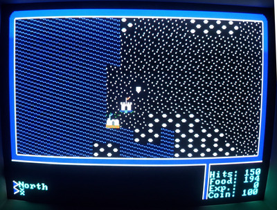

Ultima I isn't working correctly, though. It loads fine, and looks fine until I move my character - then the colors go wonky and the character (except for the shield) disappears! If I go to stats or into a town (which is also missing come colors), it resets the colors, but they go wonky again as soon as you move the character. The grass and trees turn white as well.
The Ultima I versions I've tried are from my original Ultima I-VI series CD, the Ultima Collection CD, and some random downloads. The one on the CF card right now works correctly when that card is mounted with DosBox.
I've also booted the system up with nothing but a boot floppy, along with many variants of himem, emm386, devicehigh vs device, etc. No changes.
I've updated the quality of the Ultima I pictures! 😀
    385.17 KiB
    775 views
    When the game first starts, it's all fine
    404.81 KiB
    775 views
    One move in any direction and this happens

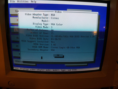

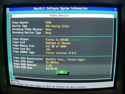

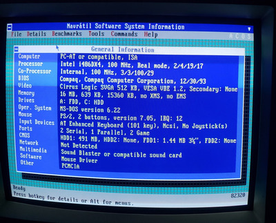

Ok, here are the results!
    345.49 KiB
    769 views
    System specs
    427.8 KiB
    774 views
    Video chipset results
    294.81 KiB
    774 views
    Microsoft video results

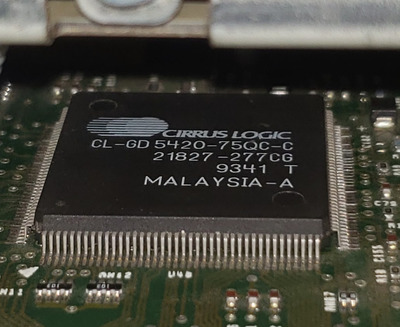

So maybe some drivers or utilities for a Cirrus Logic GD-54XX? The only problem is that the XX part covers quite a few chipsets...
Here's what's on the actual chip:
Cirrus Logic
CL-GD 5420-75QC-C
21827-277CG
9341 T
MALAYSIA-A
I also managed to get a picture of the top - it's a tough shot without taking stuff apart!

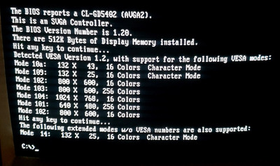

I just tracked down Cirrus Logic's IDCHIP.EXE - I'll post those results as well. (Notice the BIOS is reporting 5402 and not 5420 - prolly a typo in the BIOS?)
    136.34 KiB
    756 views
    Cirrus Logic's IDCHIP.EXE results Compaq 425

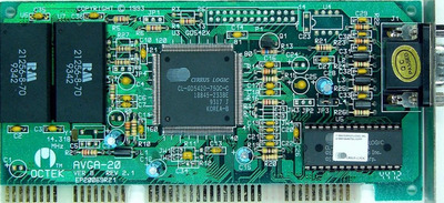

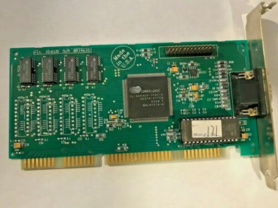

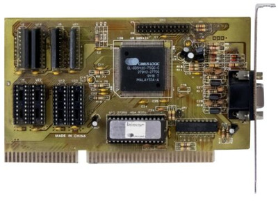

Also - if anyone has a 486 with a video card that has a Cirrus Logic GD-5420 chip, or any machine with a video card with that chip - could you try out Ultima I and see if it works for you?
ISA VGA Card CL-GD540X/5420. CL-GD5420-75-QC-C Ver 1.30 Cirrus Logic
Cirrus Logic CL-GD5420-75QC-B 16 Bit ISA VGA Card
etc..
    159.29 KiB
    696 views
    Examples of ISA video cards with GD-5420
    31.95 KiB
    696 views
