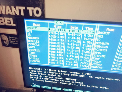

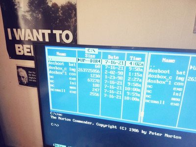

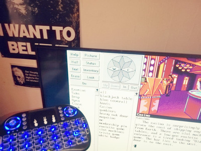

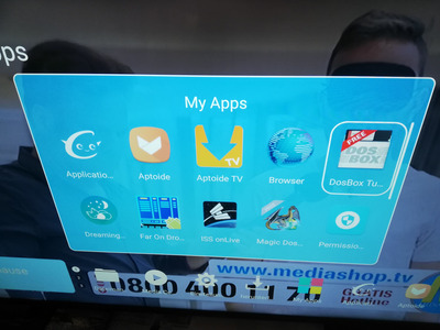

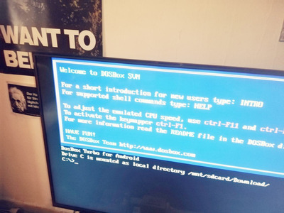

Reply 11 of 21, by Jo22
BitWrangler wrote on 2022-07-21, 01:19:
The actually useable version of dosbox to try for free on a tablet, android TV box or phone from google play is iDosBox
+1
DOSBox Turbo (Free) workes for me on an Android TV (the least "SD card" mounting issues).
On my tablet, IDOSBox works fine, too.
That's really funny, if I (we) think about it. What essentially is part of a modern day monitor, can run our vintage all of its own.
No need to attach something like a 286/386 PC, unless we special hardware is needed.
An old DVD/Blu Ray player thus becomes a fully usable Android "PC" we can run specialized software on.
Like a satellite tracker, an SDR receiver application, an AF function generator etc.
Feels a like working with tech of a post-apocalyptic world, IMHO.:
Image people wandering through the ruins of cities, looking for old consumer's electronics (appliances) which they repurpose as computers.
And the irony is, that actually works. It's possible to run an 3,5" USB floppy drive/optical drive on a SmartTV. So someone can retrieve JPEGs stored on diskette taken with a Sony Mavica camera, originally .

Forgot to comment previously but a nice photo of Gateway btw, that game is great!
