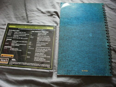

It's been a loooong time since I posted here last, but I'm at a bit of an impasse.
I recently bought a new copy of Jane's ATF (still in the wrapper). It's the version that comes in a regular CD case with a silver border around the artwork. When I installed it, the installer told me it's version 1.00f. However, I also just got a copy of Jane's ATF: NATO Fighters, and it expected the original game to be version 1.03f in order to install. Well, since there's really no patch to bring my version up to 1.03f, I had to do a little digging to find an ISO of version 1.03f so I could make sure my NATO Fighters disc worked. While I was digging, I learned that there are at least five apparent variants of the CD.

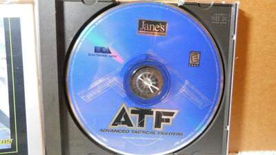

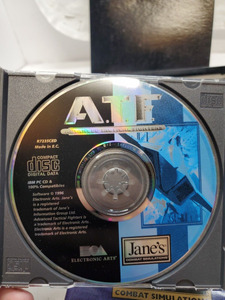

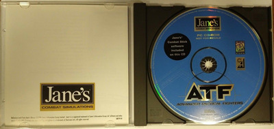

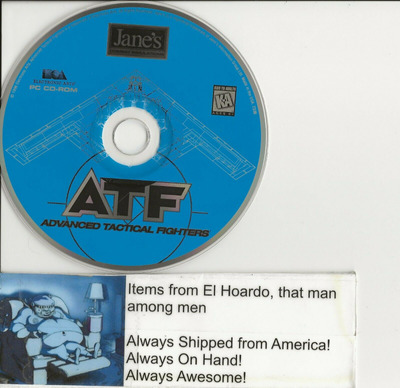

Version 3 is the one I have (it's a darker grayish-blue disc with the "E" rating), so I know that's not it. That leaves versions 1, 2, 4 and 5. I know version 2 with the deeper blue disc and the "K-A" rating on it is the "CD-Rom Classics" disc, version 4 came in a big-box that was mostly black, and version 1 I believe was an international release in a light grayish-blue big box, but that doesn't help with this obviously. Does anyone have one of those other variants to try out and see what the installer has listed for the version number? I'd prefer to not just buy a bunch of them and hope for the best, so I thought I'd ask here in hopes that someone might be able to clarify this for me (and anyone else who gets Jane's ATF: NATO Fighters).

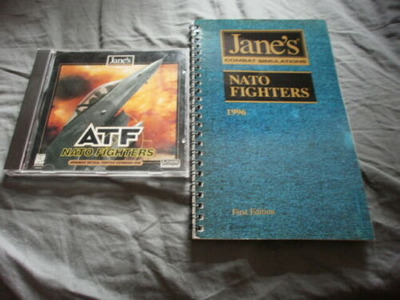

That's what my version of ATF NATO Fighters looks like. It also installs the DOS version and won't run outside of DOSBox for the same reason as above, and the title for the disc has 1.00f as part of the title when it's in the disc drive.

I remember this issue: Trouble with installing NATO fighters over a certain ATF (DOS) base version. For that reason I bought the big box, which is a match with your version 4 CD image, as it has the letters "KA" on the top right. It has the volume label "ATF_1_03F", This big box edition allowed me to combine it with NATO fighters.
When I run "AF.EXE /N" it says the following while still in the DOS text mode:
"ADVANCED TACTICAL FIGHTERS (NATO FIGHTERS), v1.00F Release
In the Readme.txt it says: "All items in the ATF_114.EXE Patch are also included in NATO Fighters."
There was also a NATO Fighters patch v1.01F specifically for Cyrix 6x86 systems, as STX already wrote. But I am not using that by default.
This is the listing of a normal (midi music) installation from the "ATF_1_03F" CD, prior to merging NATO:

AH HAAAAAAH! So it's the lighter "sky blue" disc that comes in the big mostly-black box. I had a hunch that was the one, especially when I found a German ISO of ATF earlier this evening that was also listed as 1.00f when installed (which made me doubt version #1 was the needed disc). Good to know.
Thanks for working with me to try and figure this out, STX, and a big BIG thanks to you gerwin for solving this issue for me. Now I'm off to find myself the needed copy. Hopefully this thread will be of use to anyone else who finds themselves in the spot I was in.
Reply 10 of 12, by gerwin
TheCoop wrote on 2022-07-28, 03:27:

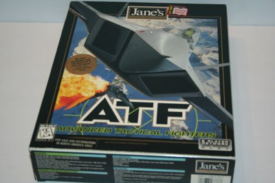

That is the one. Attached is a picture that matches the box that I have, with the golden sticker on the left and again a "KA" logo on the bottom left. It comes with the spiral binder manual.
