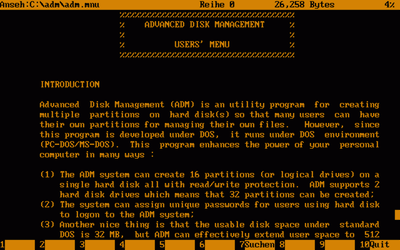

Hi again!
I found out about an vintage utility called "Advanced Disk Managment".
It had, - among other things -, the ability to create paritions beyond 32MB.
Up to 512MB, if I'm not mistaken. Very interesting.
Maybe this was one of the tools that were used in the DOS 2/3 times ?

Reply 7 of 13, by FreddyV
Jo22 wrote on 2023-02-07, 23:10:
Hi again! […]
Hi again!
hi,
Is there a documentation about how it work ?
Because without modifying DOS, it is impossible...
I would like to learn more how we can interface to / hack the DOS disk functions for my PicoMEM Project.
