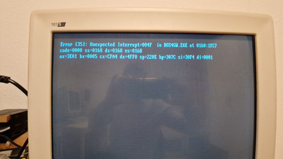

I have a the following old dos 6.22 pc
Am5x86 133mhz
ASUS pvi-486sp3
S3 virge 325 2mb
32mb fpm
Creative awe 32 ct3900
3com network card
Now when I want to play games like FIFA 97 or Duke Nukem 3D Atomic under dos 6.22 I get
1.79 MiB
944 views
This mistake. He throws both FIFA 97 and Duke Nukem 3D Atomic back to dos after about a minute with this error. Games without dos4gw work fine and High Seas trader that also uses dos4g also works fine. I haven't tried more games with dos4gw from the time of Duke Nukem 3d and FIFA 97. If more information is needed I can provide it.
Who knows what's going on here and knows what I need to do to fix this

I believe you can always use a newer version of DOS4GW. I had some issues with Syndicate, which was notoriously bundled with a buggier version of DOS4GW, and dropping in the latest version fixed it right up.
Here is the link at a Syndicate fansite. I believe I went with DOS4GW 2.01a.

Can someone explain to me how to update the DOS4GW version in Red Alert and Duke Nukem 3D? I downloaded the latest version 2.01A. I then get a DOS4GW.EXE file, what should I do with it? There is no DOS4GW.EXE in the installation directory to replace it with.
In FIFA97 there is a DOS4GW file in the Installation directory but when I replace it with the newer version I get the error that DOS4GW.EXE is a different size than expected
Who can help me to solve this?
