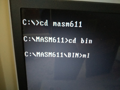

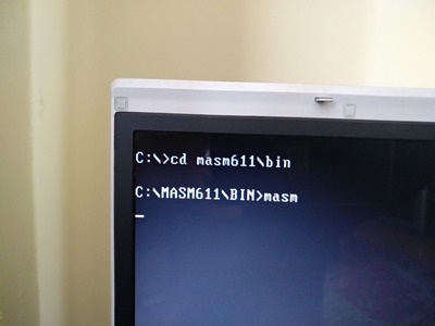

Hello, this is my first post. 😀 I've installed dos 6.22 on my laptop and masm 6.11. I wanna play with assembly language a little bit. But ml.exe and masm.exe don't run. When I press enter nothing happens, not even message how to use program.

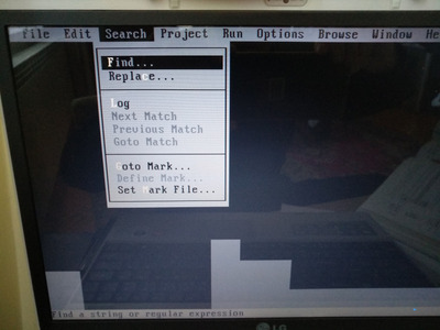

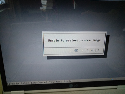

When I run pwb.exe I get this screen. Looks like memory doesnt refresh.

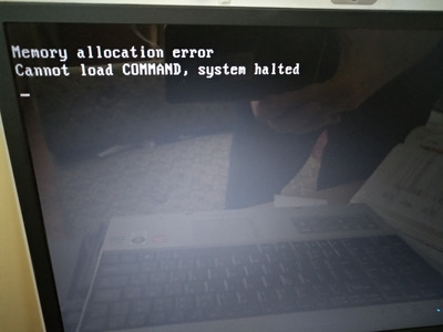

And after I exit pwb dos gives me message

Ok, so I have masm 6.11 from winworldpc and it doesn't work. I downloaded another installation from sourceforge and masm.exe is working but ml.exe generates fatal errors involving dosxnt file.
I've noticed that second installation has dosxnt.386 file in bin folder and dosxnt.exe has smaller size (393k) than in first installation's bin folder(394k). So I copy both files and now everything works perfectly. 😀))

That error is likely that your PATH is too large.
CV and PWB seem to be fussy about the PATH length.
Try changing your PATH:
SET PATH=C:\DOS;C:\MASM611\BINR;C:\MASM611\BIN;
