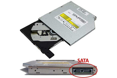

Reply 7 of 9, by dormcat
Vytay wrote on 2023-10-23, 18:14:
I am currently trying to get my dvd drive of dell inspiron 15 to work in dos but unfortunately without any success...
There are MANY generations of Inspiron 15; can you be more specific on its model number?
Optiarc DVD+/-RW AD-7585H
That's a SATA internal drive for laptop.
61.66 KiB
767 views
Booting a SATA device with DOS can be problematic; you might want to take a look at this thread: Sata CD-ROM Driver for DOS 7.1?
SATA to IDE converter is clearly not an option for an internal drive on a laptop. 😟
