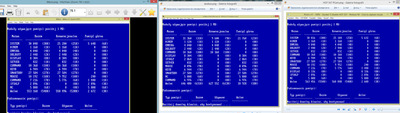

All three samples share same HDD image, I wish I could set the 86Box/PCem to make the memory management similar to how it is done in DOSBox X.

Testing done with command mem /c /p
config:
16MB of RAM
Pentium 1 90MHz
All the shadowing is off in BIOS in 86Box/PCem

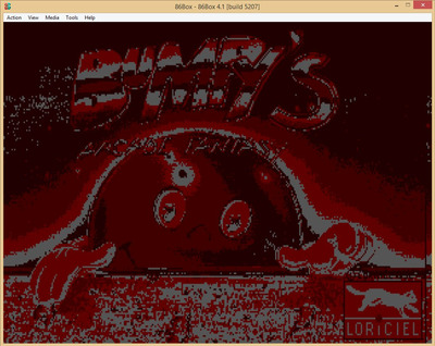

In DOSBox X the high memory seems to be better managed, most of drivers is loaded to high as expected. I'm hoping I can configure the rest to work similar to this. Loading some games as Bumpy with insufficient lower memory results with heavy display artifacts. Even though I can run the game after unloading some of the drivers, I wonder if it is possible to keep it clean and nice as in DOSBox X.

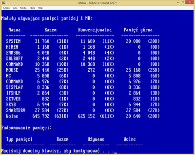

If you do not need EMS, try to replace "RAM" in CONFIG.SYS' EMM386 line with "NOEMS".
Try to create a boot menu for the configurations where you really need EMS.
And try to get rid of DRVSPACE. I'm sure you won't need it.
And, why do you have so few UMB?
It looks like 18 KB (+64 from EMS page frame).
Check for more usable upper memory areas with MSD.
Try to include them with I= settings.
Reply 3 of 5, by Gmlb256
86Box and PCem attempts to make a more accurate representation of computers than DOSBox (and DOSBox-X which is a fork). The emulated Socket 7 motherboard should normally have the region C800-EFFF available for UMB and the EMS page frame, provided that a period correct video card was selected.
As Disruptor said, try to include them with I= parameter in EMM386 and if you don't need EMS at all then add NOEMS as well to obtain more UMB.

From now on, I fixed the problem partially by changing machine type to Super Socket 7 with ASUS P5A. I'm guessing that its newer BIOS allows to have more memory.
I also changed mouse driver to newer version (also Microsoft) mouse.exe. mouse.com seemed to produce memory conflicts specifically for PCem and 86box, but not with DOSbox, I don't know why, but
dosbox-x emulates an optimized dos environment.
might be the answer here.
Here is how it been with the old mouse driver mouse.com
I couldn't load mouse.com driver together with mode codepage and keyb and ncmain. If I excluded one of these, the game worked fine and it seems like low bottom memory wasn't the case, but memory errors caused by the mouse driver (but it was fine in DOSBox with the same driver).
I have included picture how the game looked on VGA. With EGA it was black and red.
It is now solved and I hope this topic will help the other people, who will encounter same problem.
