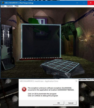

Crashes on mission load. It's also complaining "error writing career file" prior to that. Possibly an issue with the path? Dunno.
The attachment mw2pentiumcrash.JPG is no longer available

Reply 90 of 481, by BEEN_Nath_58
myne wrote on 2023-11-21, 00:41:
Funny thing is I got both the issue in 2021, but I didn't archive the knowledge I did to fix it. So let me try from a scratch, maybe it could be a little different from what you did.
  1. Install that .sdb file through .bat file.
  2. Run DxWnd as ADMIN.
  3. Import the MECH2 DxW profile to DxWnd.
  4. Select the game in DxWnd interface, go to Tools > Clear Compatibility flags, click OK to anything that follows.
  5. Double-click on the DxWnd entry and go wherever the crash occurs, don't change anything else in the profile.
The error code is for a 64-bit application and I can't remember how I got that. Error writing career file was something probably related to an error in FindFileA API but we fixed it already.
Btw, where did you install the game, and did you copy the files or install it? I assume you used the Special Installer. DPLAY.DLL, did you copy it from System32 or SysWOW64 or the CD, it CANNOT be from System32 (if SysWOW64 exists) since that's 64-bit.

I got a solution, but I don't know how it happens.
So what I did is, after your setup copies the file, I copy-replace the MW2PRM.CFG and MW2REG.CFG from CD to game, and the error (error writing career file) is gone!
Reply 95 of 481, by BEEN_Nath_58
BEEN_Nath_58 wrote on 2023-11-21, 08:33:
Ah got it in a second. Every file is read-only copied by PS!
Remove the read only setting and game works!

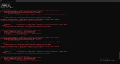

Your replacement code part gives another error
At C:\Users\thesa\Downloads\PentiumTest\TitaniumInstaller.ps1:284 char:1
Unexpected token '}' in expression or statement.
+ CategoryInfo : ParserError: (:) [], ParseException
+ FullyQualifiedErrorId : UnexpectedToken

Reply 97 of 481, by myne
I successfully made it worse.
It now crashes on mission launch without any 0x### error.

Reply 98 of 481, by BEEN_Nath_58
myne wrote on 2023-11-21, 09:08:
No you didn't make it worse. You copied "lesser DxWnd files" than required.
Case is probably solved: your package doesn't have "libogg.dll"
Reply 99 of 481, by BEEN_Nath_58
Edit: Your configuration has the "X, Y coordinate" setting changed to "Desktop". Changing this setting will break the Title bar of the game. I noticed you opted to choose the Titanium profile for the Pentium version, even when I had a different profile for the Pentium version...?
