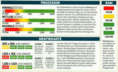

Reply 21 of 24, by asdf53
Here's the performance matrix from the magazine I was talking about (PC Games), I thought it's pretty interesting. Their definition of "optimal gameplay" (green) is around 30 FPS, I believe.
https://archive.org/details/pcgames200305/PC- … e/n115/mode/2up
They also mention that enabling "fit textures into video RAM" option in the launcher gave up to a 50% performance boost. I tested this and it had no effect. Might only work for systems that aren't CPU bottlenecked.
