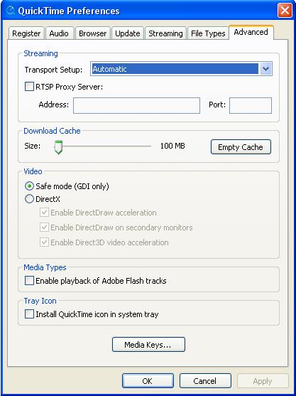

Reply 11 of 11, by drdark
Try This:
1) Install Quicktime (I have '7', should work with '6', not sure about QTA).
2) Open the Control Panel> Quicktime settings.
3) Go to the Advanced tab.
4) Under 'Video', select "Safe mode (GDI only)".
5) Click 'OK' to save settings, then run the game.
Note: Image attached.

    Quicktime Control Panel settings for Journeyman Project 3.
