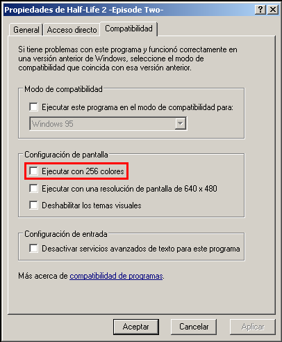

Reply 12 of 18, by eL_PuSHeR
Rank Moderator
Moderator
I am using Windows XP SP2 and I still have the option to "run in 256 color mode" in the compatibility tab.

Reply 14 of 18, by cailamaia
Heh. Sorry if I wasn't clear. I made it as clear as I could.
Yes, I have the option. No, it doesn't work properly. I have tried running it in 256 color mode, and what I get is that the characters in the foreground are rendered correctly and the colors of the backgrounds are all funky. I can upload a screencap if it will help clear up my explanation.
