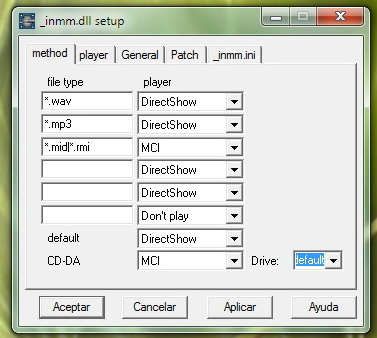

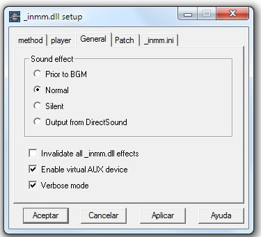

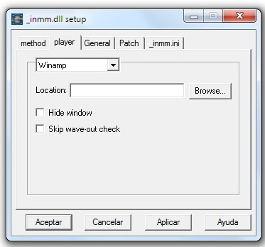

It works, so you're obviously doing something wrong. Though your post is a bit poorly written and I'm going to need a lot more information to figure out what. Let's start with some screenshots, post a screenshot of the following:
  • A hash of the .exe before and after patching it with _inmm (you can use an online service like http://onlinemd5.com/ to get the hash)
  • All of _inmm's configuration tabs
  • The contents of the game directory
  • The contents of inmm.ini

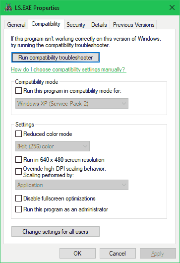

That just means it can't load some libraries. Are you running the game in compatibility mode? The properties of LS.EXE should look like this:
7.09 KiB
1564 views
Well slightly different on Windows 7, but you get the picture: none of the settings in that page should be on.
If you're running in compatibility mode that's an important thing to mention (ANY change you make to the installation must be mentioned when asking for help) and the terminology of calling it compatibility mode specifically and not Windows 98 emulation or something is also important.
Another possibility is that _inmm is complaining about something, but it should give you an error message telling you what.

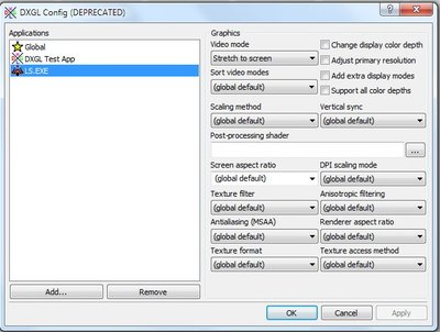

So disable compatibility mode if it's on and screenshot any messages _inmm gives you. Anyway, since I decided to install the game and look at it myself I found two more things to mention. First, you definitely need a ddraw wrapper. I'm not sure what I would recommend here. DXGL is easier to configure for sharp scaling, but dgVoodoo2 changes refresh rate (easier if you're on a 120hz+ refresh rate monitor).

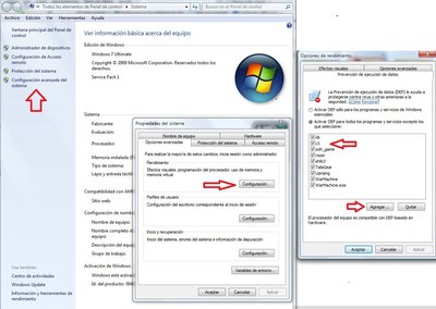

I have already fixed the error "Can not load Glue Libraries" by deactivating DEP for Ls.exe !!!! Now I just need _inmm.dll to work, how did you configure it?

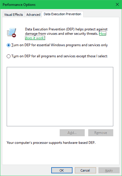

Reply 8 of 14, by ZellSF
I see this all the time and I have to ask... Why do you have DEP enabled for third party programs in the first place? It is not the default configuration for any Windows OS I have seen. The default Windows configuration has always been this:
5.5 KiB
1494 views
Just select the first radio button and all the 8 programs you've already had problems with will work and so will future programs.
I'm just so confused why I've seen so many people who have changed this setting. I'm vaguely guessing its a reading comprehension issue, that people think they have to select the second button to add exceptions to DEP without realizing when the first button means every non-Microsoft program is excepted from DEP. Is that the case? Did you read someone tell you to disable DEP for a game and you figured you had to select the second option to add it to the list?
Is it based on some popular tweak guide I haven't heard of that just fails to notify people of the compatibility problems this can introduce? Or maybe it's actually configured that way by default in some obscure Win7/8/10 versions?

The configuration images you posted are correct. As long as you've patched AUDIO.DLL I have no idea what's wrong, possible _inmm.ini is referencing the wrong files (open it in a text editor and check), you didn't post its contents so I can't tell.

I agree, I knew that was the configuration of the DEP, but you see that Windows 7 changed it in some update and as I did not remember it was like that. But well now the game goes, and for those who are interested in the configuration of DXGL I was like this

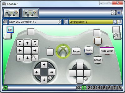

And the profile of Xpadder I have it like this:
