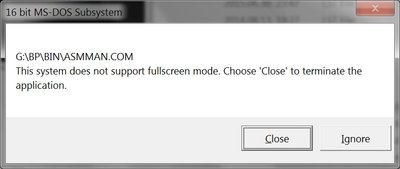

Reply 4 of 14, by Falcosoft
If '16 bit games' mean Win16 NE files then the answer is they are compatible. But only console mode MS-DOS programs that do not use any graphics modes can be run on a normal 32 bit Win7 installation (which means VGA using WDDM drivers). So practically all MS-DOS games are incompatible. You will see something like this:

Reply 5 of 14, by DosFreak
You can install the XP video drivers in Windows 7 for fullscreen mode.

Reply 6 of 14, by Falcosoft
Of course. That's why I have written a 'normal' 32 bit Win7 using WDDM drivers. I do think using XP drivers under Win7 is too much sacrifice since this way you not only break Aero/Desktop HW support but any GDI HW acceleration.
Instead of using XP drivers permanently I think a better compromise is to disable the video card temporarily in device manager (so using the built-in VGA driver) when you want to use DOS programs in fullscreen.
