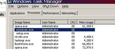

Now I encountered a strange problem, as far as I could surround the problem it is whit 16-bit applications. The application would start but not be displayed on the screen, than when i'm shutting down the application would be on the screen for a second before shutting down.
For example: I wanted to install Half Life (I know its better on W98). I see the Setup.exe running within wowexec.exe in the Task Manager, so i assume it is a 16-bit installer. But nothing appearing on the screen. So when shutting down the Sierra Logo appears for a second before shutting down. Had the same problem whit the installer of Photoshop 5, 5.5 and 6.

Well, someone told me, that Half Life runs better on W9x than on XP. While installing on the Virtual machine I also got an message about some compatibility issues.
But never the less, something is wrong whit my installation. But what. Now i just wanted to install Carmageddon II, and the same again.

This kind of goes without saying, but have made you made sure there are no unrelated ntvdm's lingering in the background? Seeing the screenshot made me recall a similar problem I had a long time ago.

Hmmm indeed. when i kill the ntvdm also the setup.exe and wowexec.exe are gone. But when i start an installer again (this time Rainbow Six) they all come back.
I'm just digitalizing - no wait wrong word - eeeehhh I'm just converting my 20 year old cd's into images and store those on an external hard disk . Found out lately that some of my cd's are faulty, so i start this procedure. While i'm sick at home 😐
What can i do about the ntvdm? What could be wrong?
