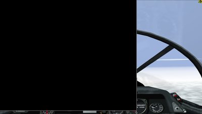

Hi!
Since I moved to the current generation of NVidia cards, I've been trying hard to get Rowan's MiG Alley running perfectly. The problem is in certain graphical artifacts:

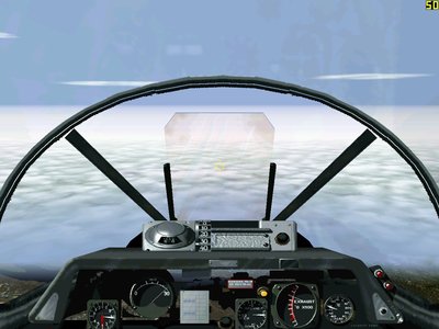

Holes in the dashboard and in land textures at the horizon, pixel trails behind moving objects, framerate dropping below 25 fps at the ground level... This is not a unique case for a DX7 game.

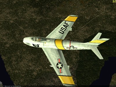

The best result so far I achieved with dgVoodoo 2: no holes, no trails, good fps, antialiasing working, even full hd resolution available. But! There is a black square across most part of the screen!:(
122.08 KiB
5646 views
This appears to be the games's loading screen, which was supposed to go away once 3D world loads, yet it stays. Or, probably, a part of game's 2D menu, running in the background - I don't know for sure. Is there a way to get rid of this black square?!

Please advise!

Reply 12 of 109, by Narzoul
Latest experimental release of DDrawCompat should now fix the performance issues affecting this game (and some other titles that rely heavily on either indexed primitives or system memory vertex sources, such as Midtown Madness 2). It shouldn't have a black box covering most of the screen either.
I'm not sure about the cockpit holes on Nvidia, since I don't have such a GPU for testing. As a matter of fact, I also don't know if the performance fix works with Nvidia GPUs at all without introducing additional graphical glitches, so any feedback is appreciated.
https://github.com/narzoul/DDrawCompat/releas … ag/experimental

Reply 14 of 109, by Narzoul
tincup wrote on 2020-06-04, 02:24:
What basic MA install should this ddraw be included with? Vanilla, v124 or bdg? I'm slow getting up to speed on this...
I've used only the official 1.23 patch, nothing else. I don't think the BDG patches should affect it in any way though.
I know there are some still some 2D glitches (which aren't there natively), mostly in the campaign screen.
Some performance drops remain too, when looking at many airplanes at once. I'm working on fixing those.
You can report additional issues also here: https://github.com/narzoul/DDrawCompat/issues/12

Reply 17 of 109, by Agathosdaimon
for my part - i am running windows 10 64bit on an ASUS ROG laptopm with the graphics card being Geforce GTX 860M.
the game exe is set to winxp sp2 compat and run as admin. Also i have only installed the 1.23 patch - the disc itself is 1.1 . i tried the DBG unofficial patch and the game would not work withit except in Dxwnd however i had all the usual graphics errors there.

Reply 19 of 109, by Narzoul
captain_koloth wrote on 2020-06-04, 10:40:
This doesn't work for me at all on an Nvidia card. Can you tell me more about your configuration, compatibility mode if any?
I have Windows 10 version 2004 with an AMD Radeon RX480 and an integrated Intel HD 4600.
Without any compatibility changes, the game fails to start with a "Not Enough Virtual memory." error message when there is more than 2GB free memory. For that, I use the GlobalMemoryStatus2GB compatibility fix, applied via Compatibility Administrator (from Microsoft Application Compatibility Toolkit). Alternatively, I think you can use any of the compatibility modes from Mig.exe's Properties/Compatibility tab, e.g. Windows 8 compatibility mode seems to work also. Older compatibility modes will apply a lot more fixes, which can sometimes just cause more issues (e.g. stuttering sound), so I recommend choosing the highest version that the game runs with (or better yet, apply only the specific fixes you need via Compatibility Administrator).
Also, the 1.23 patch is needed, otherwise parts of the menus (e.g. all tabs under Preferences) won't show up at all.
You'll have to be more specific about what "doesn't work for me at all" means exactly. Does the game not start up? Does it crash before entering a mission? Are there graphical issues? Performance issues? Is there any error message? What's in the DDrawCompat-Mig.log file?
