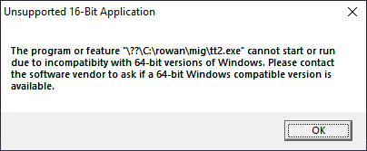

Reply 58 of 114, by Agathosdaimon

sorry its been a while, - are you using the patch from here? https://www.patches-scrolls.de/patch/2693/7/46855/download
i had no issues installing the patch for mig alley in windows 10 64bit myself - the patch is not a 16bit installer, at least not the version in the link above
Reply 59 of 114, by The_chugster
Agathosdaimon wrote on 2021-04-09, 10:11:
what is a TT2 error?
Its not the patch itself thats having issues, there is a file in the install folder called tt2.exe, this patch needs to run it but I get an error.
