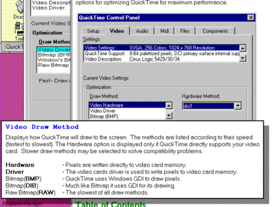

Another thing that I remember, is, that later QuickTime 2.x had several display modes (it supported the ET4000 directly, too).
I believe that was quite handy in the days of outdated VGA chipsets, strange RAMDACs and buggy drivers. 😉
