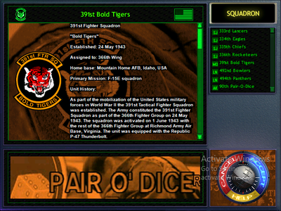

Reply 60 of 102, by BEEN_Nath_58
In fact I got the Squadron text as well as the video now, but there's more problems instead. You can't scroll the text, it corrupts them. The DirectDraw mode also works with VMware drivers, so I am confident this mode will work with many machines as well.
Reply 61 of 102, by Njinsa
Thanks for sharing this info.

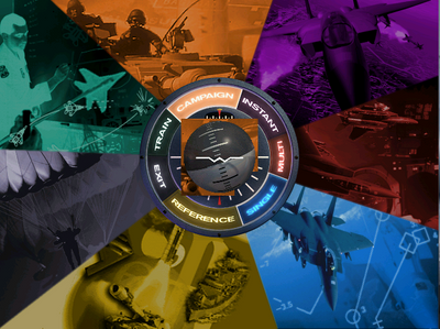

Yes, you're on right spot, there's obviously a lot more going on with DirectDraw or renderer engine.
For instance some visual artefacts in menus, you can try to reproduce:
- start hooked F-15, focus on Main menu, screen looks correctly rendered
- select Single or any other option, screen also looks correctly rendered
- return back to the Main menu, take a good look and you'll notice some background shadow mask which is removed as you put mouse over.
I's say that some heavy logging of DDraw is almost a must dor getting the clues behind this and other rendering issues.
Scroll problem could be related to the MFC controls if those are not directly hooked by F-15 executable, just guessing if that could be the same case as Janes F/A-18.
GUI subsystem on F/A-18 is a close cousin of F-15 as same Baltimore based Skunkworks reused a lot of F-15 codebase to ramp up F/A-18 development.
I don't find an issue here, can you spot with a screenshot where the problem is? Maybe there was an issue with dgVoodoo2 that I don't remember, but I don't see it with DxWnd. And probably you are right about the scroll thing that doesn't get hooked, but why it doesn't is the question, and if it is hooked, why doesn't it display?

Thank you for your efforts. I saw that GHO tried to assess the weird nature of game layout but it proved not to be worth of an extra effort. Although DXWND development continues with more or less probable solution for DDRAW, I found a solution which works perfectly with Janes F-15.
It's right here - https://github.com/elishacloud/dxwrapper
After clean install and v1.17 patch, extract following files in F-15 root folder: dxwrapper.dll, dxwrapper.ini, ddraw.dll, dsound.dll.
dxwrapper.ini file need some configuring in order to activate direct draw v5 and direct sound translation.
Endgame - no more screen clipping, menus working again, text is displayed correctly.
Oh, briefing animations work like charm, no need to rename UV2 files any more.
