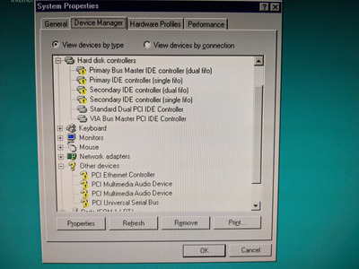

I want to install the chipset drivers because all my IDE devices in device manager have an exclamation point. See attached pictures.

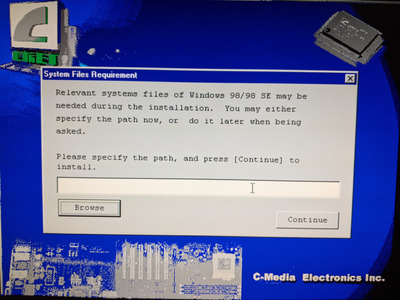

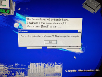

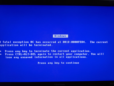

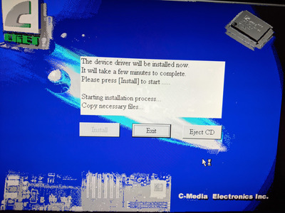

This one is interesting. When I try to install this in normal mode, I get a BSOD that lets me continue using the computer after I press any key (See attached picture). When I try to install it in safe mode, the Setup.exe file actually starts, goes through the initial process but then asks me for a directory of Windows 98 system files. See attached pictures. I haven't been able to find any directory that lets me proceed with the installation. I have notably tried System, System32, System32/config and a few others. Watching Phil's video, he's using this same file and his installation proceeds successfully without asking for a directory.

I did a fresh install. The many attempts I made to install the Chipset drivers had pretty much destroyed the WIndows install, my CD-ROM drive disappeared and all the IDE drivers were showing an exclamation sign.
Chipset:
From the Chipset driver installer (via_hyperionpro_v524a) I installed only the VIA AGP driver, the RAID config Utility and the VIA RAID Driver one at a time. This got rid of the unrecognized RAID device in Device Manager. I was not able to get the INF file package installed, nor the PATA/SATA driver.

The driver installer (cwi8738-winme644) stopped giving me a BSOD once I disabled the onboard audio from the BIOS, and the installer itself finished installing after I pointed the pop-up window to the Windows98SE CD. Full sound working and one more unrecognized device solved.
