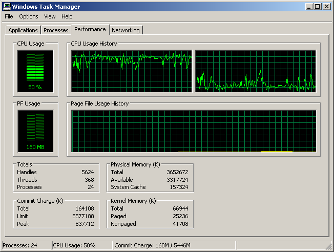

Reply 9 of 51, by darry
Sphere478 wrote on 2021-02-25, 07:49:
Darry I have some initial results for ya. […]
3megs/sec at 80% cpus usage with usb 3.0 gigabit nic
4.5 megs a second 70% cpus usage with 10/100 pci nic
These results are kinda weird. Obviously neither neither the network, the cpus or the pci/usb are saturated. I wonder what is slowing it down...
This is fast enough for my uses over the network though but is going to be quite the pain transferring files.
Thoughts on speeding it up?
I am not surprised that that the USB NIC has bigger CPU usage . USB has some overhead that would be considered practically negligible on newer systems, but is quite perceptible/measurable on 24-year old hardware .
As for the CPU usage itself, I believe that you likely are hitting a bottleneck there . That 70% or 80% usage figure is the cumulative of both of the CPUs in your system . If, for example, one of your CPUs is at 100% and the other CPU is at 50%, you will get a total load at 75% . What that means is that whatever is running on the CPU at 100% is likely being squeezed . Windows schedules processes as effectively as possible to give each of them as much CPU resources as possible, but a given process thread can only run on one CPU at once .
Here is an example . I am running a single Prime95 thread on one CPU core on a dual core machine. Prime95 will use as much of that CPU core as it can and will, in effect, be limited by it, but total CPU usage will still show as 50% . In your specific situation, one of the CPUs is likely at 100% and the other is at or near 50%, so the total comes out to 70 or 80% .

Reply 10 of 51, by Sphere478
darry wrote on 2021-02-25, 20:37:
I am not surprised that that the USB NIC has bigger CPU usage . USB has some overhead that would be considered practically negli […]
I understand what you mean. What’s odd though is my two graphs were kinda equal. Where as you can see yours are lopsided.
