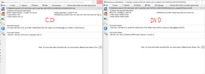

What I meant by "objectively better" you can see in the attached screenshot (even though they cheated in the DVD version regarding FPS and resolution - more here https://www.youtube.com/watch?v=VorkPCeDVgY): The DVD Version has higher resolution, higher bitrate, better coloring.

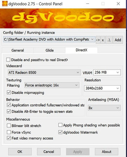

I have small starfield issues in fullscreen mode (pointy lines while moving the ship), but it´s nothing that kept me from playing and finishing the game twice.
I got the best results with those settings:
download/file.php?id=121949&mode=view
I did notice the issue is worse on NVidia cards (AMD seems to be better). Don´t remember if I ever tested on Intel IGP.
Maybe Dege (creator of dgVoodoo2) could look into the issue. I will contact him.

Doesn't work. Failure initializing input devices. I'm using the original CD version. It was working before your patch, btw. […]
Edit: deleting dgvoodoo's dll files fixed the error message, but the videos are black even in software mode.
Now I've noticed that the original unpatched version also isn't working right in d3d mode, with or without dgvoodoo.
Edit 2: Finally tried this "upgrade" on the GOG version. It works, but the videos take AGES to load. Ironically they look worse than the CD version. The letterbox is not centered, the bars are gray instead of black, the image is less sharp and it just looks like a low-quality DVD, whereas the CD version has that proper old 256-color FMV look.
The GOG version comes with a custom ddraw.dll that enables anti-aliasing and anisotropy, so it looks pretty good without any tinkering.
Dgvoodoo works too, but the starfield leaves lines on screen above 640x480.
Save yourself the trouble, stick with GOG.
had same issue. solved by updating DgVoodoo DLLs to latest
