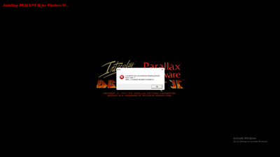

I am trying to install Descent II on my PC but the installer stops while it goes through the DirectX installation or check. Can anyone tell what's going on and what should I do to bypass this issue?

What version of WIndows are you trying to install that on? What version of the game, retail CD, GOG downloaded, etc?
Windows 11, Retail CD

Does it install any files at all or does it attempt the DirectX check and installation before installing the game?
The problem is that installer for DirectX was written for Windows 95, and 11 is blocking it.
If the installer extracts the game files and then fails. You could try a Descent source port. The source code for the game was released and there are several projects where people have updated it to work on modern systems as well as adding features like widescreen support, and handling modern controllers. https://www.descent2.de/

The game doesn't install anything.
I don't have issue running the game at all, it runs just fine, DOS bobbing issue doesn't exist too. I need a way to install it, because the files copied off Windows 8 32-bit installation writes some configuration somewhere (not in registry) and thus I have to fix my installation folder at a certain location (C:\). The issue is, I have just 1 drive partition on Win8 32-bit and I don't install games on C:\ drives for space reasons.

I found a solution. The game doesn't use traditional InstallShield Archives, instead it uses the WinARJ extractor.
Going to the D2DATA folder of CD, I extracted DESCENT2.SOW using WinARJ command-line and transferred "D2-2PLYR.HOG", "D2-2PLYR.MN2", "D2CHAOS.HOG", "D2CHAOS.MN2" to a subfolder names "missions", another file named "DESCENT2.DEM" to "demo" subfolder, put the EmulateHeap shim on the game, limit the FPS to 60 and the game was running in it's original glory.
