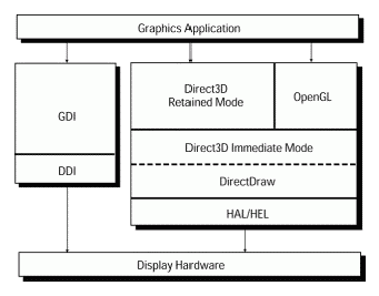

Beware, long answer ahead! 😁
Nearly all Direct3D games ran in software mode, originally. As I said before. Software rendering was the norm, not 3D acceleration. There weren't much good 3D cards, anyway.
The "Reference Rasterizer" in DirectX ran via CPU and had best image quality, too. It was the one which implemented all possible features of Direct3D.
Again, this was the mid-late 90s, another time. The 3D accelerators primarily helped people with weak CPUs. The poor ones who couldn't afford a Pentium Pro, MMX or Pentium II.. 😉
And before someone complains: No, the all-mighty 3dfx Voodoo was not a Direct3D accelerator. Not primarily, at least. It was its own thing.
Succesful, but something in its own reign. Like S3 Virge with S3D or the Nvidia NV1.. The Voodoo used Glide API and had a miniature OpenGL (MiniGL ).
By 2000, after DirectX 7 was released, the situation changed. The Software Renderer was nolonger sufficient, nolonger being updated.
Games now required a 3D card in most cases or they wouldn't run. Late games like Need for Speed II SE ran in software mode, still, for example.
Edit: Before another someone complains.. 😉 Yes, there were Direct3D 3D accelerators, as early as the mid-90s. Not all of them were bad.
However, it was a wild-wild west scenario, by today's standards. DirectX evolved so quickly and graphics drivers were hit-and-miss.
By comparison, the software renderer "just worked" (more or less). Windows NT 4 didn't have 3D acceleration, even.
It got DirectX 3a support somewhen in mid '99, with the release of SP6, afaik.
That being said, not all games required the latest DirectX/Direct 3D once a new DirectX runtime was out.
The DirectX 3 to 6 feature level was used for years. Especially in the indie scene.

No. 3d hardware had been planned years ahead of Direct3D. 3dfx Voodoo papers at least go back to 1994. A lot of common 3d techniques were set in stone with SGI.
Jo22 wrote on 2023-01-24, 18:08:
No they didn't. Only a few offer Direct3D's software mode and they're usually retained mode clunkers from 1997 (Lego Island, MSVRML, etc). Early Direct3D games that also had a software renderer were their own independently written software renderer (Hellbender, Jedi Knight, etc)
These games having software renderers of their own does not imply VirtualPC is any good for 3d acceleration.

Only if there was no 3D acceleration available. It was available and known as HAL popularly then and was differentiated from software processing. Most games used DirectDraw in mid 90s. D3D got popular post-1997 afaik. In absence of DirectDraw hardware acceleration they used software acceleration but I don't remember calling it "Reference Rasterizer", I knew it as "HEL" (Hardware Emulation Layer) [avoid confusion with HAL]. The first time I heard about "Reference Rasterizer" was in DirectX7 which included a reference d3dref.dll file.
The Direct3D software emulation equivalent was Direct3D Ramp and RGB, which goes as old as in Shadows of the Empires.

I still don't get it. Games with Direct3D support that also have a separate software mode, do not even utilize any of the D3D dll files in that mode. You can delete all of them, IM, RM, Ref, etc. and software mode would still work.
Granted, I haven't tested enough old D3D games, that's why I asked for examples. It's quite interesting to check them out.
EDIT:
I've encountered an odd behavior with Zoo Tycoon, which isn't even a 3D game. It loads d3dim700.dll at launch, and would crash if it's not present. I have no idea why a non-3D game would load a file that has no 2D purpose (ddraw.dll is responsible for that stuff pre-D3D8), but I've come across explanations that some games utilize such files for things besides rendering.
P.S. I'm aware of the history of 3D on PC, 3dfx, non-MS APIs, etc.
leileilol wrote on 2023-01-24, 19:06:
Only a few offer Direct3D's software mode and they're usually retained mode clunkers ...
Now these I have to test. Do you know of any D3D immediate mode games that run in software?

If you delete the D3D dll files, the Direct3D path of the games does not even work; either the game throws an error at launch, complaining about the missing files, or the Direct3D option becomes disabled.

D3d immediate mode games in software? Frogger 1 has a no-3d mode that uses Ramp, Shadows of the Empire has RGB and Ramp devices too.
Reply 28 of 46, by eddman
Thanks. Honestly didn't know there were software D3D games.
The thing is, I'd already checked Shadows of the Empire a while back and never saw any D3D software options. I tested it again just now. So the problem was, I was launching it with Sote.exe, and "Game Options" does not show the 3D Device option. I didn't know I had to use Shadows.exe for that.
I wonder with what other games I've missed their hidden options.
Um, Retained Mode was the *real* Direct3D to my understanding. 🤷‍♂️
It was the sophisticated one with a full concept of a scene, as far as I know.
That immediate mode was for devs who couldn't handle it (just kidding), thus implementing the 3D world in their own game/engine.
Sure, they may had trouble using software mode without extra code. That'd make sense.
D3D RM was capable of running via CPU all alone, if I'm not mistaken.

It was available and known as HAL popularly then and was differentiated from software processing. Most games used DirectDraw in […]
Pardon. It's been so long - I started "getting into" these things near the end of the 90s. 😅
At the time of which DirectX 6.x/Windows 98SE were around and DirectX 7 just around the corner.
It's well possible that I'm mixing some things up and am using terminology from DirectX 7.
The term HEL is more appropriate, I suppose. I remember it, too.
By the way, who coined the abbreviation for HAL?
Was HAL a reference to H-A-L 9000, by any chance? 😂

Jo22 wrote on 2023-01-25, 04:45:
What does real mean in this context? The overwhelming majority of 3D games (even the early ones) didn't use RM. Apparently IM offered more control of the hardware, which is probably why game devs chose it over RM. It seems MS stopped updating RM after DX3.
That's the thing. Apparently most 3D games didn't use any D3D components in their software mode at all, be it IM, RM, Ramp, etc. They do exist, as evident by the examples posted by BEEN_Nath_58, but they were not common.

Reply 32 of 46, by BEEN_Nath_58
Probably in Direct3D2/3 era, it was Retained Mode dominating (Lego Island? and more). As retained mode was stopped from updates past dx3, devs went to Immediate Mode (they learnt it better by then)
Yes it was.

Okay, time for facts. Kids, please sit down and listen. :)
"Historical origins of Direct3D
Direct3D can be described as a graphics operating system, although it would be less pretentious,
and perhaps more accurate, to refer to it as a 3D graphics back end. Its core function is to provide
an interface with the graphics hardware, thus insulating the programmer from the complications
and perils of device-dependency. It also provides a set of services that enable you to implement
3D graphics on the PC. In this sense it is similar to other back ends, such as OpenGL and PHIGS.
But Direct3D is also a provider of low-level 3D services for Windows. In Microsoft's plan the low-
level components of Direct3D (immediate mode) serve and support its higher-level components
(retained mode) and those of other 3D engines (OpenGL).
In the beginning 3D was exclusively in the realm of the graphics workstation and the mainframe
computer. The standards were PHIGS (Programmer's Hierarchical Interactive Graphics Systems),
and GKS (Graphical Kernel System). During the 1980s it was generally accepted that the
processing power required to manipulate 3D images, with its associated textures, lighting, and
shadows, was not available on the PC. However, some British game developers thought differently
and created some very convincing 3D games that ran on a British Broadcasting Corporation (BBC)
micro equipped with a 2MHz 6502 processor. This work eventually led Servan Keondjian, Doug
Rabson, and Kate Seekings to the founding of a company named RenderMorphics and the
development of the Reality Lab rendering engine for 3D graphics. Their first 3D products were
presented at the SIGGRAPH '94 trade show.
In February 1995, Microsoft bought RenderMorphics and proceeded to integrate the Reality Lab
engine into their DirectX product. The result was called Direct3D. Direct3D has been one of the
components of DirectX since its first version, called DirectX 2. Other versions of the SDK, namely
DirectX 3, DirectX 5, DirectX 6, and currently, DirectX 7, also include Direct3D. The functionality of
Direct3D is available to applications running in Windows 95/98 and Windows NT 3.1 and later. The
full functionality of DirectX SDK is part of Windows 98 and will also be found in Windows NT 5.0
and Windows 2000. This means that applications running under Windows 98 and later will be able
to execute programs that use Direct3D without the loading of additional drivers or other support
software.
"Retained mode overview
Retained mode was designed as a set of API for the high-level manipulation of 3D objects and
managing 3D scenes. It is Microsoft's competition for OpenGL and other high-level 3D
development environments. It is implemented as a set of interrelated COM objects that enable you
to build and manipulate a 3D scene. Its intention was to make it easy to create 3D Windows
applications or to add 3D capabilities to existing ones. The programmer working in retained mode
can take advantage of its geometry engine, which contains advanced 3D capabilities, without
having to create object databases or be concerned with internal data structures. The application
uses a single call to load a predefined 3D object, usually stored in a file in .x format. The loaded
object can then be manipulated within the scene and rendered in real-time. All of this is done
without having to deal with the object's internals.
Retained mode is tightly coupled with DirectDraw, which serves as its rendering engine, and is
built on top of the immediate mode. OpenGL and other high-level systems exist at the same level
as retained mode. Figure 14-2 shows the elements of this interface."
"Immediate mode overview
Direct3D immediate mode is a layer of low-level 3D API. Its original intention was to facilitate the
porting of games and other high-precision and high-performance graphics applications to the
Windows operating system. It allows access to hard-ware features in the 3D chip and offers
software rendering when the function is not available in the hardware. The intention of immediate
mode is to enable applica-tions to communicate with the 3D hardware in a device-independent
manner and to provide maximum performance.
In contrast with retained mode, immediate mode does not contain a graphics engine. Code that
uses immediate mode must provide its own routines to implement object and scene management.
This means that the effective use of immediate mode requires considerable knowledge and skills
in 3D graphics."
"Hardware abstraction layer
In Figure 14-2 you see that both the Immediate and the Retained Modes of Direct3D are built on
top of the Hardware Abstraction Layer (HAL). It is this software layer that insulates the
programmer from the device-specific dependencies. The Hardware Emulation Layer (HEL)
provides support for those features that are not present in the hardware. The combination of HEL
and HAL ensure that the complete Direct3D functionality is always available."
"DirectDraw
DirectDraw, the subject of Part II of this book, is the Windows rendering engine for 2D and 3D
graphics. DirectDraw functions enable you to quickly compose images into front and back buffers,
and to apply transformations, blitting, and flipping. The result is a capability of implementing
smooth animation as required in computer games and other multimedia and high-performance
graphics applications. DirectDraw functions can be used with images that originate in the Windows
GDI, in Direct3D, or in OpenGL.
DirectDraw is implemented as an API layer that lies above the display hardware, as shown in
Figure 14-2. It enables the graphics programmer to take advantage of the capabilities of graphics
accelerators and coprocessors in a device-independent manner. DirectDraw is a COM-based
interface."
Source: DirectX 3D Graphics Programming Bible (2000)
    6.13 KiB
    1630 views
    Figure 14-2
Reply 34 of 46, by Joseph_Joestar
Jo22 wrote on 2023-01-26, 12:22:
The combination of HEL and HAL ensure that the complete Direct3D functionality is always available."
While this may be true in theory, practical results are quite different. For example, you cannot turn on EMBM in Drakan (and similar games) if your graphics card doesn't support that feature, even if HEL could theoretically render the effect. Same goes for paletted textures in Final Fantasy 8 on graphics cards which don't support that feature in hardware.
Maybe I'm misunderstanding what the author of the DirectX 3D Graphics Programming Bible is saying, but real-world testing using period correct hardware and software doesn't reflect that statement.
Reply 35 of 46, by eddman
The full functionality of DirectX SDK is part of Windows 98 and will also be found in Windows NT 5.0 and Windows 2000. This mea […]
software.
Unless I'm reading it wrong, this is simply saying that since DX files are included with Windows itself, games don't have to include additional software to make it work. That's all.
The Hardware Emulation Layer (HEL) provides support for those features that are not present in the hardware. The combination of HEL
I suppose it means to say that devs can code their games to use D3D features in software mode (HEL) if they wanted to, but seemingly not many did, evident by the games that fail to utilize certain features if they're not available in hardware. In other words, just because a game is coded to use D3D, doesn't necessarily mean it'd fallback to HEL if the hardware is missing features.
