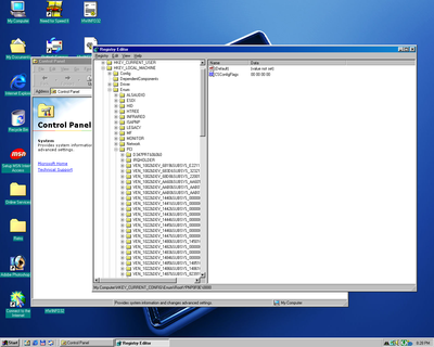

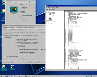

HKEY_LOCAL_MACHINE > ENUM > PCI
*Windows 98 is very PCI tolerant as you can see in the attached image, on a newer motherboard there are like 50+ PCI devices
