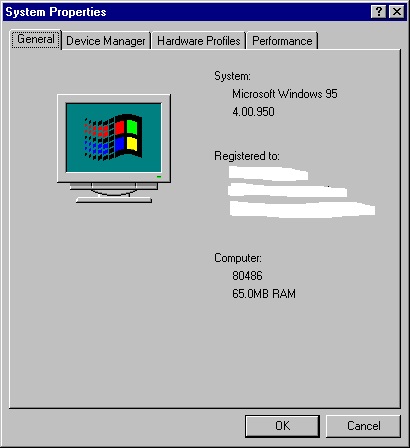

I upgraded it to 128MB of 8M x 36 FPM Parity memory, it is all recognized at POST but when I tried to run memtest (only version 3.5 on regular memtest not memtest+ would load) it only found 65MB, I have windows NT 4.0 installed and it also only recognizes 65MB (yes 65 not 64).

I tested some more, with just two 32MB sticks in Windows (switched to 98, more tolerable startup time) reports 64MB, add another stick and it says 65MB. I ordered some non parity memory to see if that will have any different results. The memory that was previously in the system was non parity but only a couple 16MB sticks, if I add the new stuff with the old stuff and it goes past 65 in an OS then I know the parity memory is causing issues for the system.

Reply 8 of 15, by trowa
sliderider wrote:
Don't forget that 64mb is 65,536 bytes so that may be confusing you into thinking it is 65mb and not 64.
Yes I understand the math, attached is a picture, it quite literally says 65MB with 128MB inserted. Every OS I've thrown at it says this, if I use just two sticks (64MB) it will say 64MB.
