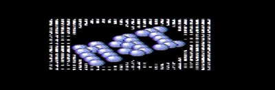

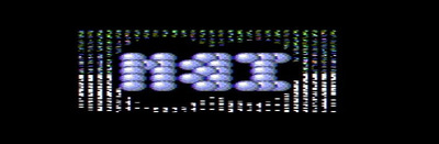

A screen capture of the vector balls part(all other screen captures are the same, except the IBM logo turning differently):
29.24 KiB
2826 views
Vector balls, color surrounding it
29.46 KiB
2826 views
Vector balls, b/w surrounding it
As can be seen, the surrounding image doesn't change, it's static(only the vector balls area does).
It also keeps switching between those two surroundings, nothin in-between(some pixels changed or anything like that). It's just a static image surrounding it, blinking between color and b/w modes it seems.
Edit: OK. Looking at some earlier captures it changes a little bit, but only at the beginning of the vector balls part, not when it's fully running a second or more.

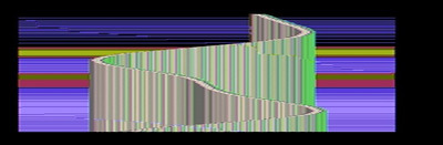

One interesting thing I noticed: when running the scanline racing, some kind of staircasey thing started to appear, which I think I saw returning multiple times during the part of the demo:
40.29 KiB
2471 views
Staircasey thing starts to appear
Edit: So it's still 104-124 metric cycles short. Since metric cycles are the amount of PIT cycles, that means 416-496 CPU cycles are missing somewhere?
