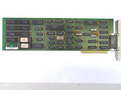

Well, i have three ISA cards that I do not know what they are (video card?, RAM expansion?)
Can you help me?

[INS Corp.] P/N 6113483 - BOARD WITH CPU MOTOROLA MC6809P

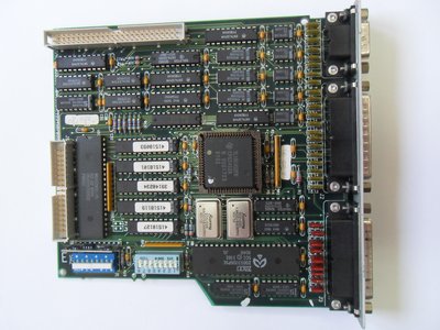

    I/O board???

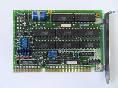

    W26361-D431-Z2-3-5 * RAM Expansion???

If I didn't know any better I'd say that the first one is a CGA card, the second one is indeed an I/O board, and the third one I have no idea about.

First one could be a SDLC adapter card.
Second some IO-controller, But no ISA.... But I See a Zillog Z08530 (serial port), a WD37C65C (a NEC Floppy controller), so it's some kind of IO. Unfortunately the picture does not show the numbers on the right. And a picture from the other side would also be cool.
And the third refers to an Siemens Computer according to the numbers on the card. At least there is a battery on it and some Ram 8 NEC D4464C-15L. And according to google it is 192 x 8 Bit static CMOS Ram. So some kind of BIOS card, strange is that is not on the mainboard.

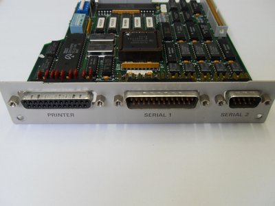

For Roman78: here's the back of the 2nd card (I/O controller?!?)

Back of the I/O card 01

    I/O card 02

Presumably, some kind of proprietary ribbon cable was used to attach that I/O card to some specific motherboard.
Without both the ribbon cable and the specific motherboard, there's really no point in keeping it around.

The last card contains a battery and ram.. Perhaps that's a ram disk for a proprietary machinery ?

1) SDLC adapter
2) Not a PC ISA card. Not PC stuff maybe. I'd say it is mainboard of a laser printer or something, but the floppy controller would not make sense.
3) 64 kilobytes of SRAM with battery back-up. So of course this is not CMOS RAM for BIOS, and quite small for a RAM disk. It could however be used to back up some code or data during power outages, so a system (a factory) can continue from where it was. Or maybe it is a ROM emulator for developing bootable BIOSes, who knows.

the #2 is from a test system or data aquisition system. i dont see any common marks from its age (racal dana, keithley, bk, hp etc)

1. SDLC adapter
2. data acquisition system
3. SRAM
