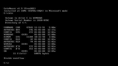

When I try to execute any dir command or program it terminates with a "Divide overflow" printed after the directory listing. Trying to execute a program makes MS-DOS 5.0 give a "<FULL FILENAME PATH HERE> NOT FOUND" error. Trying to execute the IBM PC AT diagnostics' DSETTUP.EXE clears the screen with the cursor in the top-left corner and hangs. Trying to execute the Day of the Tentacle demo's INSTALL.EXE from a floppy disk makes it show the installation wizard, saying it detects the disks (and to select one or press the letter of the harddisk to select it) then terminating with a "Divide error" in the top-left corner of the screen.

I've just tested the latest build (using XT-IDE AT and IBM AT BIOS w/ my 20MB primary and 8GB secondary hdd image). The divide overflow at dir still persists?
65.11 KiB
499 views
Divide overflow at the end of MS-DOS 5.0a's dir command.

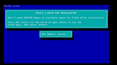

The same can be said about the divide error when starting the Day of the Tentacle demo setup:
63.11 KiB
499 views
Day of the Tentacle demo setup on AT 80286-8 crashing with Divide error.
The divide by zero error handler isn't started by any DIV instruction (according to the Visual Studio Community 2015's debugger breakpoint)? Anyone knows what might cause this strange behaviour? No divide errors of any kind happen on the 808X and NEC V20/V30 emulation.
After debugging the it shows that the divide interrupt is called by a hardware IRQ? It's executed at C600:141D, which is the XT-IDE AT BIOS. Also some other locations get this 'IRQ' called, but it seems something is wrong in the interrupt controller? Since interrupt 0h is only possible with IRQ0 and IRQ8 with a base address having been set to vector 00h on the interrupt controller?
Edit: Looking at the PIC, it seems that for some reason, the IRQ0 is stuck as being used, causing the PIC to keep reporting the IRQ as used, but the PIC results in interrupt 00h because the cause of the interrupt cannot be found. So the cause is actually the PIC that's doing something wrong.
