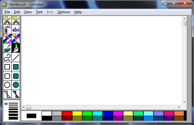

Reply 2 of 100, by collector
It actually works, if not completely. Here is Paintbrush from Win3.1 Running on my Win7 Pro x64.

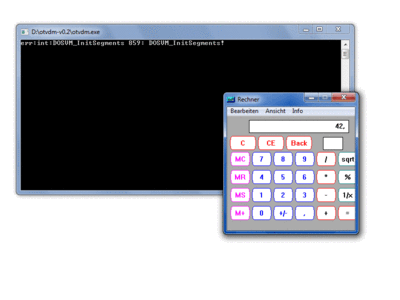

I did extract otvdm-v0.2.zip, changend to that folder and ran "CMD" in the address bar which gave a command line window.
Then, I ran otvdm.exe together with a Win16 program : otvdm calc.exe
After that, the command line window just hung. Nothing.
EditI I'm using Windows 7 x64 on an Athlon 64 X2 PC.
Reply 6 of 100, by Jo22
NJRoadfan wrote:
otvdm.exe --app-name your.exe
Ok, just tried again. It works now. I used drag&drop this time (dragged calc.exe onto otvdm binary). 😀

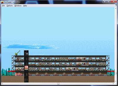

Reply 10 of 100, by collector
Sim Tower. I had to create "WINDOWS\SYSTEM" subdirectories in the otvdm folder to copy WAVMIX16.DLL and WAVEMIX.INI to get it to run. Seemed to run well, if not a bit too fast for the few minutes I played it.
    83.85 KiB
    17706 views
The Sierra Help Pages -- New Sierra Game Installers -- Sierra Game Patches -- New Non-Sierra Game Installers
Reply 12 of 100, by collector
Which is included with WineVDM. The WAVEMIX.INI from the CD should go in a WINDOWS subdirectory inside of your WineVDM directory and WAVMIX16.DLL from the CD inside of a "SYSTEM" folder under that WINDOWS folder. I should do an installer for Sim Tower.

Reply 15 of 100, by NJRoadfan
My 1.0 release CD doesn't have the uncompressed copies on it. I got it installed anyway. Runs but crashes trying to save or load a game file. The VDM has significant overhead. SimTower runs like its on a 486 on a Core2Duo.
