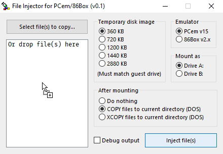

However, I think my "quick file injection" Windows tool is pretty much finished already.... so, if anyone feels like doing a bit of testing, I'd appreciate the input:
PCemuFileInjector.zip
319.01 KiB
796 downloads
Should be quick and easy to use:
  • If you don't have it already -- install ImDisk Virtual Disk Driver (takes care of creating the temporary disk images transparently)
  • Just run the tool, and select (or drag/drop) the files you want to transfer.
    Whenever you have the emulator window open at the DOS prompt, you can simply click "inject files", and it'll do all the work for you - including COPY/XCOPY commands, if you select the respective option.
9 KiB
11600 views
My use-case involves frequently updating and transferring the same file(s). In that case, you can simply keep the tool open with a fixed file list: when you click "inject", it'll always grab the most recent copies from the host filesystem.
If anything isn't working right, you can also tick "debug info" for more verbose output to help troubleshooting. But hopefully that should be rare, unless there's something massive I've missed...

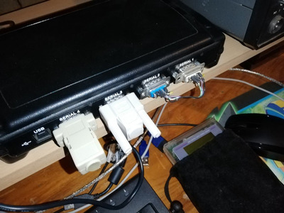

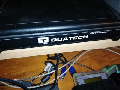

I'm using a multi USB serial adapter box for such experiments.
It has 4 ports - two are connected by a nullmodem, the others have test plugs attached.
I assume with an additional circuit using an dual opto-coupler (one LED, two phototransistors or photodiodes) it's possible to tap a serial line, too.
Two discreet transistors (BC548, 2N2222A etc) will do, too.
One transistor is used for TXD to RXD, while another transistor in parallel is used to send a copy of the data to another port's RXD.
The sending part can be done via pull-up/pull-down, I assume.
Anyway, the signals are TTL, anyway. Only a few USB to RS-232 converters do +12/-12v, afaik.
Those converters that I've seen in the past years use +5v/0v rather. Or worse, +3.3v/0v. +/- 3v is the very limit for RS-232 when it comes to detecting data, afaik.
