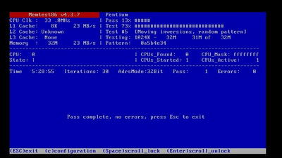

After implementing the DRBA values from Bochs for the different memory sizes, it gave a setting error once, then after clearing the CMOS it still detected 16MB RAM only, even with the new DRBA values loaded when they're written (128MB).
Although when disabling the IDE and enabling all other hardware it won't detect the HDD/CD-ROM anymore, but does boot the floppy drive correctly 😁
UniPCemu Git repository
Reply 13 of 71, by superfury

Now running Memtest86 from a boot floppy on the i430fx. It's almost at 50% of test #7(total 48% so far). No memory errors are reported.
Now, why does the IDE controller not work? Anyone knows more about the i430fx IDE controller's workings? Why can't it handle it properly(it's based on the osdev article on it(a generic PCI IDE adapter documentation))?
Edit: The Memtest86 application has just completed it's memory checking and checks out without errors(1 pass), apparently.
So the memory seems to have no errors in it's emulation?
58.66 KiB
2148 views
Memtest86 completed it's checks without errors.
