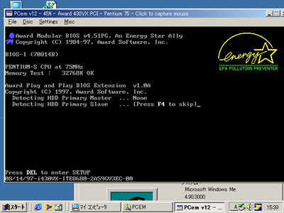

Reply 4 of 8, by leileilol
That's one way to get the release to work. 😀
Direct3D crashes on this though, and these earlier PCems don't have good options for fullscreen video.
