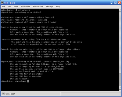

I've found an easy solution to convert raw HDD images to VHD format.
Microsoft's VHDTool has a converter function for this.
Maybe that's useful to all of you who are 'upgrading' from 86Box/PCem or Qemu to VPC*. ;)
Please just don't forget to rename the file extension to *.VHD.
    48.54 KiB
    583 views
    /convert parameter (run in andLinux shell, because it's so fancy)
