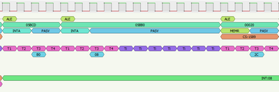

In the ongoing pursuit of emulator cycle accuracy, I'm investigating the cycle timing for interrupts. Specifically, waking from a HALT.
I have an 8088 on a microcontroller and what I have discovered is that there is a somewhat significant delay between INTR being asserted and the first INTA bus cycle.
Here I assert the INTR while halted and step the CPU...

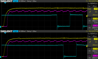

I see either a 7 or 8 cycle delay. The additional cycle delay is less frequent, but frequent enough to see.
I confirmed this with a scope, see attached. Yellow is the PIT channel 0 output. It's interesting to see it has a slow enough rise time to effectively delay INTR a half cycle.
I stuck a probe on HOLDA just to make sure the delay wasn't caused by DMA. My arduino-controlled 8088 has no DMA controller, so I had pretty much ruled that out anyway.
Anyone know the underlying rules or logic for interrupt acknowledgement on the 8088?

I was able to disprove any sort of two-cycle phase as I can delay 10, 11, or 12 cycles after halt before asserting INTR and see the same delay value. Interesting from your code that it appears to be related to the last bus transfer type?

very minor point, but the 8088 ignores the first INTA, and uses the second.
here's a timer interrupt. You can see there's nonsense on the data bus for the first INTA and then we have 8 on the second.
17.69 KiB
1207 views
bus sniff of INTA cycles
of course if you're latching the vector internally to your emulator, it doesn't really matter.

As a quick question: why does the 808x perform 2 INTA cycles for that? What is the purpose of that first (discarded) INTA?
Edit: Found a bit about that first 'byte' INTA result:
https://rakmaya.tripod.com/Chip8259.htm
So basically, the 8259 acknowledges the IRQ(updating IMR and ISR) and sets up for a read vector to be read on another INTA pulse. It doesn't drive the data bus during the first INTA, thus the 'garbage'?
