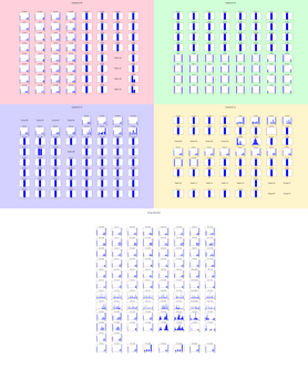

Version 1.1 was recently merged, no actual test changes but the test disassembly was updated.
I've been playing around with data mining the tests with Python. Here's an example of the sort of thing you can do, histograms of cycle execution time for all 8088 instructions:
warning: big image
324.8 KiB
410 views
8088 cycle timings
