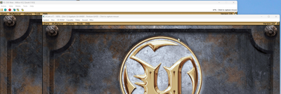

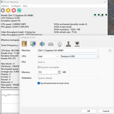

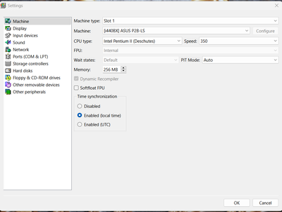

Thanks everyone and thanks Bruninho for your help and patience ! Don't get me wrong about 86box , I think it's an impressive software as well. It is just probably I am not doing somethingwell. I just run a new test using the latest 86box nightly (new recompiler) and here are the results compared with pcem17 straight from the website.
As you can see in the test, pcem17 runs 100% and 86box hovers around 70% with a voodoo 3 3000, same config (4 threads). PCem can drive a 450 mhz p2, and 86box is running a 350mhz p2
As with previous suggestions, core affinity is set to the first 8 pCores to avoid them landing on a eCore.
My host config is a i7-12700k, no overclocking, 4080 RTX. I run the VMs from a NVME drive. Is there any other specific config you would like me to share?
EDIT: I realized I was using 64bit version of 86box, so tried the 32bit version as well, but numbers are similar, maybe a bit better.

IIRC the 32 bit builds run better on Windows, yes. I just don't remember why.
I just needed to know which host cpu you had - since the entire emulation runs in a single core of that cpu. Refer to the geekbench's single core score of your CPU:
https://browser.geekbench.com/processors/inte … -core-i7-12700k
You're attempting a P2 450MHz with Voodoo 3000, You can maybe lower the P2 clock a bit to find out a sweet spot by trial and error (I mean, until you achieve a more constant 100% with proper speed for the games). If that is not enough, going from a Voodoo 3 to a Voodoo 2 12MB should be, and also this config should also perform better in PCem v17 for you. Unless you have a game that specifically requires a Voodoo 3 (I don't think any game does, as long as they are 3dfx compatible any voodoo will work).

The entire emulation is not single core. The guest CPU emulation is single core, but accelerated non-voodoo cards (Trio, Virge, etc.) have their own thread, and voodoo cards have at least 2 threads. A v2 in SLI can go up to 9 extra threads. The UI, CD audio, MIDI and each network card also have their own threads.
