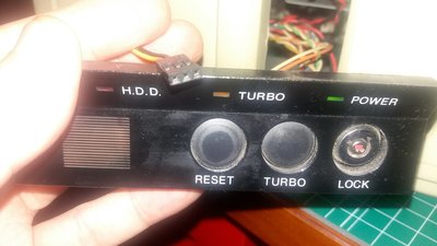

One of them is the display located in the front panel case, the CPU Clock Speed Diplay.

Front panel
The CPU is an Intel 486 DX4/100Mhz. 66 Mhz in "normal" mode and 100 Mhz in "turbo" mode.
In the mainboard side I found the place to connect the Turbo switch and Turbo LED, both works. The LED turns ON when the Turbo button is pressed.

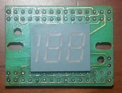

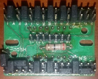

Display gaps

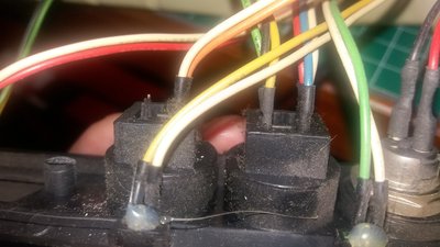

From the Turbo button there are other cable that I suppose was connected to the numbers display.
1.38 MiB
1149 views
Turbo button
And here is the problem, the numbers display is allways off.
I had try to connect the cable in all free positions using the three gaps but nothing seems works.

Reply 2 of 5, by TheMobRules
For the numbers display to work you need to provide +5V from the power supply. It's the last two pins in the center row of the display, labeled G (Ground) and 5V.
Most AT power supplies came with a 2-pin +5V connector for this purpose, if yours does not have it you can build one, or use one of those Molex to 44-pin IDE power adapters.

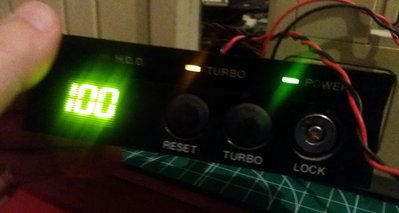

1 MiB
1037 views
100Mhz :)
Thank you very much.
All answers have helped me.
I made a cable to take the power from the CPU fan connector to the two first pins (+5V and G) in the display.
With this, the number 50 is displayed. 😀
After this I closed the next two pins with a jumper, only for testing, and then the number changes to 100 😁
Since I have no key to lock/unlock the keyboard I decided to use their cable from turbo button to display's pins 3 and 4.

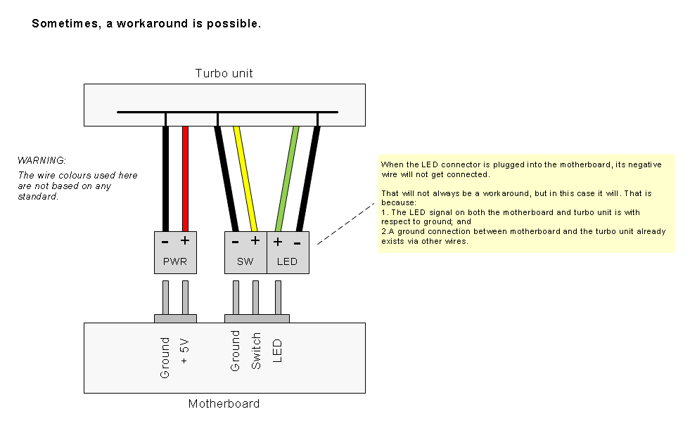

After all is similar to turbo_switching schema provided by SSTV2.
