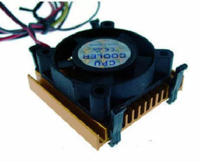

I have a question about your CPU cooler. I'm using one of these on a 5x86, but it is the same. However the label that yours is showing in the 'up' position, is actually down against the heatsink. Should it be like yours?

Looks to me like the label is on the fan's hub. Is yours? Most fans have a side with the hub exposed, and the other side has the braces that hold the motor assembly. Sometimes that side has a sticker, sometimes it doesn't. Likewise for the fan hub itself - sometimes stickered, sometimes not.
If you wanted to flip the fan hub-side-down, you would have to ensure the hub does not interfere with the heatsink fins. It's OK if the motor side touches the sink, but contact with the hub would prevent it from turning smoothly or at all (...obviously). Then you get to choose whether you want air blown on to the top of the sink, or pulled through it. You don't always get a choice, but when you do, I generally prefer to suck air through the fins of the sink and expel the exhaust through the fan, up and away from the board. At least until the exhaust air gets VERY warm, then I like to have the fan blowing cool air into the heated area, but that's more to improve the serviceable life of the fan (by not baking its lubricants dry). Opinions may vary.
Thanks
TW
I was going to use the “evercool” 486 CPU heatsink with fan but I change motherboard and CPU’s.
So I did not use it.
I am using the Intel Overdrive CPU with has a heatsink but no fan built in.
Reply 52 of 213, by TimWolf
Yes I have that very same unit. For some reason my fan was the opposite direction. I've turned it over now. Played a few more hours of C&C Covert Missions last night, and it still kept nice and cool.
Thanks
TW
Mine spins counter clock wise and pushes air down onto the heatsink.
