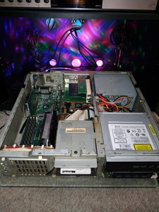

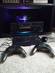

TRICK OR TREAT!
Hello all, I felt this would be an appropriate first post..
I recently completed a gaming console 98SE build I consider (and call) my FRANKENSTEIN...
It's a Gateway NLX motherboard in an IBM cab and riser...

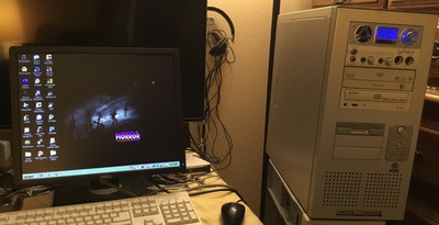

Reply 42 of 117, by Intel486dx33
R.I.P. Halloween build. It was working fine then started acting up and just died.
It's been sitting for a year and just died. The drives and DVD started acting up
And now everything is corrupt.
I will have to rebuild it.
But for now I still have my Meg-Aluminum Monsters working with Win98se and Voodoo-3-3000 cards.
They have Sound Blaster live ! Sound cards and paired with the Klipsch Pro Media 2.1 speakers they sound Awesome.
Very nice.

that's a pretty cool, consolified pc

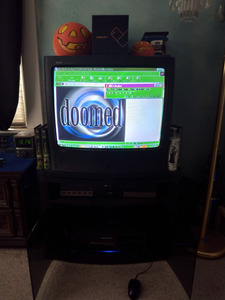

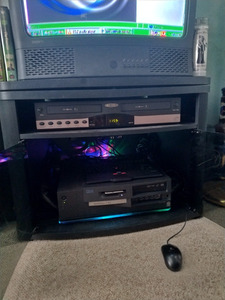

Thank you!
Yes exactly (perfect description)
I was looking for a replacement for my Atari Jaguar, which I havent used in years.
As well as a failing DVD player.
Clearly space is a problem, a tower would simply not fit.
I avoided NLX builds for years, never even considered them.
I planned on making this an IBM, but my experience with it proved impossible.
Ibm has security measures that prevent bootup if they trigger, I believe it may be bad caps as well.
Tried two different Intellistation boards, neither started up reliably. Just not worth it.

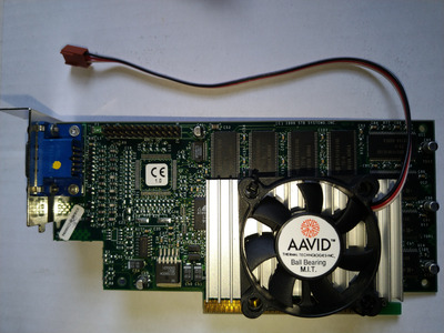

Jabil Maverick 440BX NLX (Latest Gateway Bios)
IBM cab and riser
1000mhz Intel Pentium 3
768 MB Ram
WIN 98SE
Voodoo 3 3000 (Breakaway corner removed using Side Cutters (trying to break it off scared me))
to Fosmon VGA to composite adapter
Creative SB AWE 64 Gold directly to tv audio in
Linksys WMP54G ver 4.1 (with Ralink driver and software, not Linksys)
3com card
Stratitec USB 2.0 to front hub mounted in bay behind removable panel
Currently streaming SomaFM:Doomed - Halloween time only internet radio...

Back in the day, when I found a IBM PIII computer for my boss to use XP on as I was transitioning from 98SE in 2003 thru 2006.
If you change the PIII CPU on particular IBM machines especially intellistations, you have to rerun the bios update. You heard me right. That due to TPM feature, other than that, bios settings can be changed without needing that disk except CPU.

I had a similar experience with this one as well...
Upon acquiring, I tested to bios for functionality, then stripped cards for upgrade. After reading the pdf, I learned processor upgrades have special rules. A Pentium 2 requires one to change a mobo jumper to meet the processor speed. A Pentium 3 did not require this, however it did require a bios update for any changes in speed at all. Scenario would be, after switching out a processor the startup would halt with "unrecognized processor, update needed" or something... Surprisingly this was easy enough considering a bios update can be difficult to update from such an old machine (and IBM has changed hands since). IBM Lenovo still had a support page with an available bios update. Very impressive support!
Problems I could not defeat more stemmed from a sometimes will, sometimes won't startup. Like it would start successfully ever 3rd or so time...but not necessarily even then.

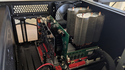

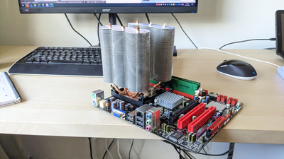

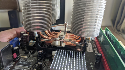

Reply 58 of 117, by Almoststew1990

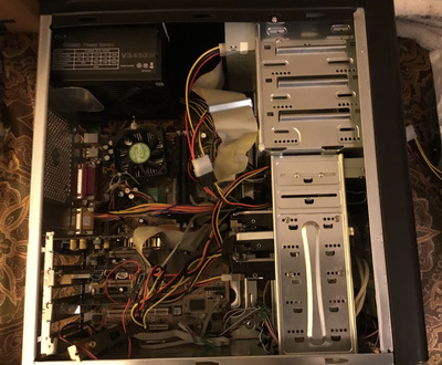

AI've got a build that's upsetting and viewer discretion is advised...
I got a Socket 478 build with PCI-e and DDR2 RAM. It's like an early socket 775 but worse in every way.
Then there is the cooler. I am passively cooling a Pentium 4 with a thermaltake Sonic Tower! And it's not as if I'm using an interesting S478 CPU, just a 2.4GHz Northwood. I could have just used a slow 775 P4.

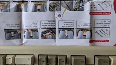

Then there is how the heatsink is mounted to the CPU and bracket. It used the force of screws pressing against a flat bridge thing over the heatsink. The screws do not go into a screw hole. It was impossible to so up tightly without the bridge over the heatsink sliding around. Its also impossible to do up tight for the above reason and the baffling reason to require an Allen key in the enclosed space between the two heatsink towers when a screw driver would be able to screw in much easier. I'm getting nervous sweats thinking about the heatsink pinging off.
But at least I'm pairing it with a good GPU right? No I'm using an 8600GT because I hate myself.
The idea is I was going to have a Northwood Unleashed kind of build, with fast DDR2 RAM, a fast GPU and an SSD. But now I'm too scared to stand the PC upright.
Reply 59 of 117, by shawnhell
Almoststew1990 wrote on 2021-10-14, 16:36:
Is there a way to cross-secure the already existing assembled bracket down more by adding a few zip ties ? Really small ones?
I've been using them more lately myself. I used them to mount the fan on the Voodoo 3 in the picture I posted earlier.
