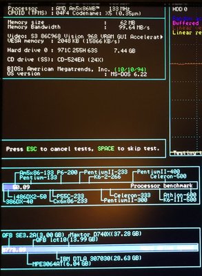

This Intel 486dx4-100 Overdrive CPU has a high CPU benchmark score and standard AMD 5x86-p75-133.
Speedsys benchmark scores:
Intel Overdrive 486dx4-100 score = 38
Standard AMD 5x86-P75-133 score = 50

Reply 21 of 26, by Anonymous Coward
Errr...I think you're misreading your own benchmarks. The Intel gets 38, and the AMD 50.
However, keep in mind that these are synthetic benchmarks. Speedsys is notoriously inaccurate for measuring older CPUs. Try comparing using something like DOOM. It's already been discussed somewhat, but I think it's been accepted that the Intel DX4 is just about the same speed as an AMD DX5-133. This is apparently because intel made some enhancements to the ALU and FPU in their DX4, whereas AMD just slapped on some extra cache.
Reply 22 of 26, by Intel486dx33
Okay, referencing other benchmark scores this Intel Overdrive CPU scored 3 points higher than a standard 486dx4-100.
Standard Intel 486dx-25 score = 9
Standard Intel 486dx-33 score = 12
Original Intel 486dx2-50 score = 18.1
Standard Intel 486dx2-66 score = 18.6
Intel 486dx4-75 = 29
Standard Intel 486dx4-100 score = 35
AMD 5x86-P75-133 @ 166mhz = 60
Reply 23 of 26, by TheMobRules
The score not only depends on the CPU itself but other things (chipset, RAM), see the "Ultimate 486 Benchmark Comparison" thread: an Intel DX4-100 WB scores 42. My own DX4-100 in WB mode scores almost that much.
I bet if you compare a standard DX4 in WT with the overdrive version using the same motherboard and RAM you would get pretty much the same score.
