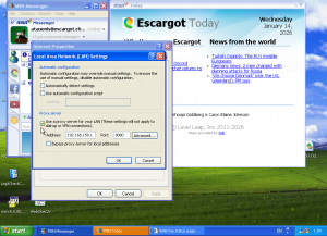

Reply 244 of 245, by bedrock
Thank you for the reply. I believe I have the proxy settings correctly in IE6 on WinNT 4, but I hadn't imported the old ciphers onto my proxy server VM. I have now, but unfortunately it has made no difference. Please let me know if this is the right place for support or I should open an issue on github page?

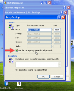

I'm don't see attempts to access MSN login server in log. Below is an example how it should look.
14.01.2026 12:09:10.894+417196 >CONNECT nexus.passport.com:443 (192.168.159.13)
14.01.2026 12:09:10.986+254534 >[nexus.passport.com] GET /rdr/pprdr.asp (192.168.159.13)
14.01.2026 12:09:10.986+285027 Fix to https://msnmsgr.escargot.chat/rdr/pprdr.asp internally
14.01.2026 12:09:10.986+286204 >Downloading content...
Probably this is because the MSN Messenger client attempts to connect to it bypassing proxy.
Try to specify this configuration:
This is under XP, but I have previously tested with NT4, and it worked too.
If this don't help, try to open anything via HTTPS in MSIE6, say, https://google.com. Does it working via WebOne?
