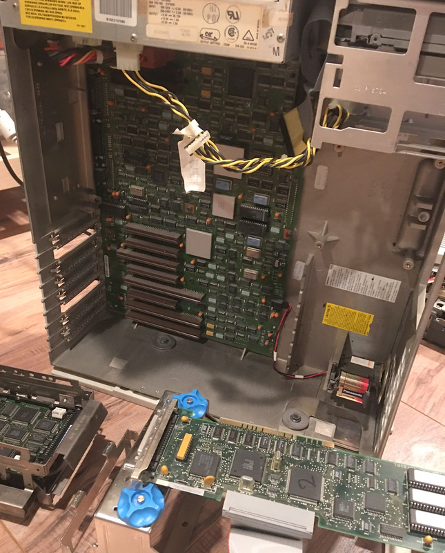

Standard floppy drive but issue is knowing how to make a modified floppy cable out of standard floppy cable and resistors, split out the cable to supply the power. Too much technical skill and error is high, risky. Option is join the facebook PS/2 group and ask there to have this adapter made and shipped for a price.
Or have the floppy drive shipped to someone who knows how to fix these.

Reply 24 of 35, by Niezgodka
Oh nice. If I will make it working the right way, I will probably get one of these sound cards 😀
Here is a picture of my motherboard:
I noticed, that my floppy connector is with pins, but that FDD adapter is a slide card like. Do I put it into MCA port? Which side up?
Like I said, I replaced the battery, disconnect hdd and fdd, and I still have same codes, however now computer is getting into some IBM Basic
Don't know much about it. I tried to set the date, but it does not take dos commands 🙁
Reply 25 of 35, by BitWrangler
Goes to BASIC if it finds nothing else to boot from.
Reply 26 of 35, by luckybob
Niezgodka wrote on 2021-11-30, 04:56:
aww fuck, I hope he hasn't sent it and you can get a refund. Don't plug it in, its for other styles of machines.
I can never remember which machines have the card edge, and which ones have pins.
The floppy cable is non-standard, so be careful not to damage it. But if you have some spare 40-pin ide cables and some 36-pin connectors, you can make your own. (double check before you go ham) https://ardent-tool.com/floppy/Floppy_Pinouts … 0-pin_Card_Edge
in a nutshell, IBM in its infinite wisdom, didn't like the clutter of extra power cables. They also wanted to just be a dick. So they put the power and data on the same cable. (mostly) It's 100% hackable if you have the patience. you take a 40 pin cable, run the right wires to a standard 36-pin floppy and connect up some of the extra 4 wires as power to a standard floppy.

Reply 29 of 35, by Niezgodka
Ok. So I canceled the order. Can anyone help me with such cable?

Reply 34 of 35, by pentiumspeed
Floppy drives has to be matched to correct face plate too, and the rail!
That compounds the search for replacement. Restore your floppy drive first before deciding to replace.
PS: with electronic minded, one can make a adapter to use standard floppy. The difference in need for pull up resistors.
