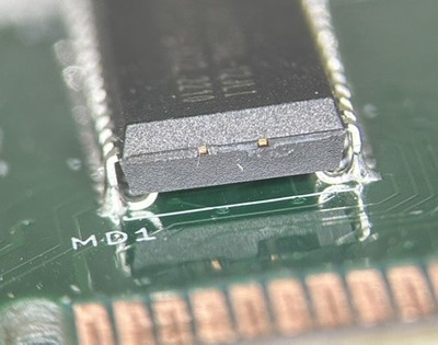

Reply 104 of 121, by RockstarRunner
We printed the PCB, the SRAM pads look quite the same as the last one, you did link the latest version?
Bottom line is it can be soldered by someone who is good, but to make it possible for less capable people (myself 😉) the pads could be maybe twice as wide, to the outside direction.
Reply 105 of 121, by rasz_pl
picture? From the old one
it looked like problem was on the inside with chip legs laying on base pcb, not the outside. The new one should be hot air solderable. Tin all pads with solder, put chip on top, 30 seconds with hot air and its done.
I slapped extra ridiculously oversized footprint into this:

can you take a photo of this one? I dug around in my stash and I dont have any chips in this weird footprint 🙁 and cant find any 3D models to fit in kicad.

Reply 107 of 121, by miisalo
I think the pcb is not feeling well
258.13 KiB
540 views
Chip overboard! Abort mission!
EDIT: Oh snap, too clever for us. It's the oversized one just for the test.
Reply 108 of 121, by RockstarRunner
After blood returned to brain from weight lifting, we understood the assignment 😆
40.66 KiB
532 views
108.42 KiB
532 views
Looks good to solder via hot air or iron, good stuff.
Reply 109 of 121, by rasz_pl
miisalo wrote on 2024-03-22, 18:11:
Cmon, Im not that incompetent 😜
RockstarRunner wrote on 2024-03-22, 18:22:
too bad you didnt line it up with second row so I could precisely see where metal touches. Inner size looks almost perfect, outer slightly too long?
Reply 110 of 121, by miisalo
rasz_pl wrote on 2024-03-22, 19:40:
We lift iron, we no blood in brain, we stupid. Seriously after our regular gym session we even count one, two, many, lots..... *staring at distance* .
But I don't think out size is too long as long as those can be fit in to the module nicely. Probably easier to solder using normal solder and iron as you can warm up the pads with "regular" solder tip. Then again, are people who don't have good equipment and soldering skills going to solder these anyway.
