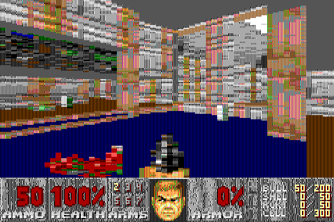

Hello, I saw some YouTube video from ViTi95 running FastDoom in EGA 640x200 16 colors with dithering.
Is it possible to try it from official build ? I took a look at the README and try many of the executables. None of them offers dithering.

640x200 EGA was deprecated for being too slow a few major versions ago

Yes, the 640x200 EGA dithered mode was deprecated for two reasons. First the chunk-to-planar process required to convert the 320x200 256 color backbuffer to a 640x200 16 color planar is really CPU intensive, too much even for a fast 486. Second, EGA cards are mostly 8-bit ISA, which have a very limited bandwidth available. In worst case scenario, you need to update 64.000 bytes from VRAM, 35 times per second. That requires 2187Kb/s transfer rate, while 8-bit ISA bus only goes up to ~940kb/s in my tests.
The current EGA executable uses this 640x200 resolution, but generates a non-dithered 320x200 image. This way I can use latch copy tricks to avoid the chunky-to-planar conversion and bottlenecking the ISA bus.
